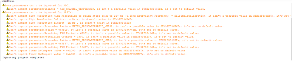

Hi again - I tried with the new version V4.22 and found it still cannot import my project without errors.
I get these errors when I try to import a project TO AN IDENTICAL MCU!
 Some parameters can't be imported for ADC1
 Can't import parameter:Channel = ADC_CHANNEL_TEMPSENSOR, it isn't a possible value in STM32F334K4Tx, it's set to default value.
 Some parameters can't be imported for HRTIM1
 Can't import High Resolution:High Resolution to reach steps down to 217 ps (4.6GHz Equivalent Frequency) = DLLSimpleCalibration, it isn't a possible value in STM32F334K4Tx, it's set to default value.
 Can't import High Resolution:Calibration Rate, it doesn't exist in STM32F334K4Tx
 Can't import High Resolution:Timeout (in ms), it doesn't exist in STM32F334K4Tx0690X00000607JHQAY.png

I reproduced the issue you highlighted on the latest CubeMX release.
For your information, our development team are working on some features that will improve the Import project functionality. I can't give you any date for the moment but you will see some improvements in the future.
For the moment, the workaround is to edit the ioc file and change thePCC.PartNumber and theMcu.UserName from
STM32F334
K4Tx
to STM32F334
K6Tx.
I hope it will help you.
