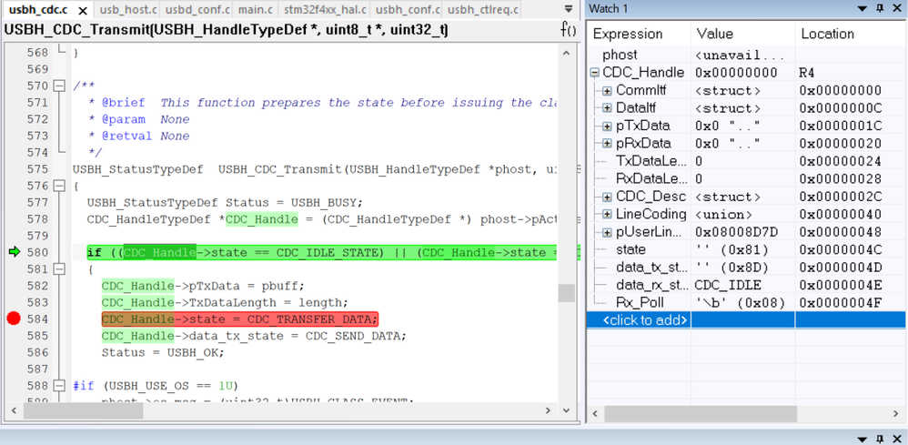

I am struggling for a while to get the CDC_Host to work. Steps that I have taken are:
  1. Create a MX Cube USB Host HS port project
  2. set correct frequencies 8Mhz for HSI, heap=1200 stack 800 (tried various values with no effect)
  3. Generate the code (eWarm and CubeIDE code - no difference when running)
  4. Flash to a Disco407 board
  5. connected the USB host connector to PB14,15 via a USB sniffer to a STM32F103 board
The results I see is that the device enumerates on the host successfully (goes thru all stages and ends with set_configuration1 and getlinecoding packets).
However when I send a USBH_CDC_Transmit API then that packet does not get send out. I did debug the code see below. I did find the point where the transmit fails to initiate the packet based on the CDC_Handle status (incorrect status code e.g. 0x81 instead of CDC_IDLE etc).

I followed Breakpoint to
usbh_cdc.c routine
  * @brief  This function prepares the state before issuing the class specific commands
  * @param  None
  * @retval None
USBH_StatusTypeDef  USBH_CDC_Transmit(USBH_HandleTypeDef *phost, uint8_t *pbuff, uint32_t length)
  USBH_StatusTypeDef Status = USBH_BUSY;
  CDC_HandleTypeDef *CDC_Handle = (CDC_HandleTypeDef *) phost->pActiveClass->pData;
  if ((CDC_Handle->state == CDC_IDLE_STATE) || (CDC_Handle->state == CDC_TRANSFER_DATA))
  // --->Here the if then statement breaks... CDC_Handle->state = 0x81 which is not a valid enum state at all e.g. CDC_IDLE_STATE etc.
    CDC_Handle->pTxData = pbuff;
    CDC_Handle->TxDataLength = length;
    CDC_Handle->state = CDC_TRANSFER_DATA;
    CDC_Handle->data_tx_state = CDC_SEND_DATA;
    Status = USBH_OK;
#if (USBH_USE_OS == 1U)
    phost->os_msg = (uint32_t)USBH_CLASS_EVENT;
#if (osCMSIS < 0x20000U)
    (void)osMessagePut(phost->os_event, phost->os_msg, 0U);
#else
    (void)osMessageQueuePut(phost->os_event, &phost->os_msg, 0U, NULL);
#endif
#endif
  return Status;
0693W000005BR9WQAW.pngSo should CDC_Handle be a static variable? I could not find the assignment again but saw it before that a malloc statement was used. Do I have a memory leak here?

Finally found the issue... too much time behind the PC.
The error is in the definition-->extern uint8_t USBH_CDC_Transmit(uint8_t* Buff, uint16_t Lenn);
USBH_CDC_Transmit takes three arguments instead of two (phost is missing).
