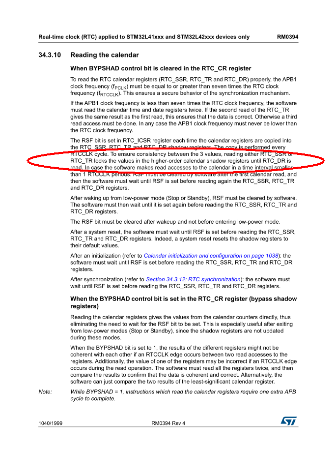

 > Unfortunately, I couldn't find this useful tidbit in the 412KB reference manual.
This is the very purpose of having shadow datetime registers at all.
However, FYI, this mechanism is flawed in most STM32, see RTC calendar registers are not locked properly erratum in many STM32 errata. It's hard to tell whether this applies to the 'L412 too - it's latest (and only) errata are dated 2018 while the above erratum is dated late 2016; but ST refuses to publish detailed list of IPs versions used in individual families/models.
PS. It's also documented in Cube in the doxygenoid "header" to HAL_RTC_GetTime(), in the current (April 2020) version https://github.com/STMicroelectronics/STM32CubeL4/blob/master/Drivers/STM32L4xx_HAL_Driver/Src/stm32l4xx_hal_rtc.c#L859

Ugh... That feeling when asking a question, and then getting the exact file, line, and charater in the comment for the actual function presented to me after having claimed to have read the docs. I could have sworn I RTFM.
Thanks for researching the citations.
Its okay. We all do feel like this from time to time... :) Those beast of manuals have thousands of pages for reason.
