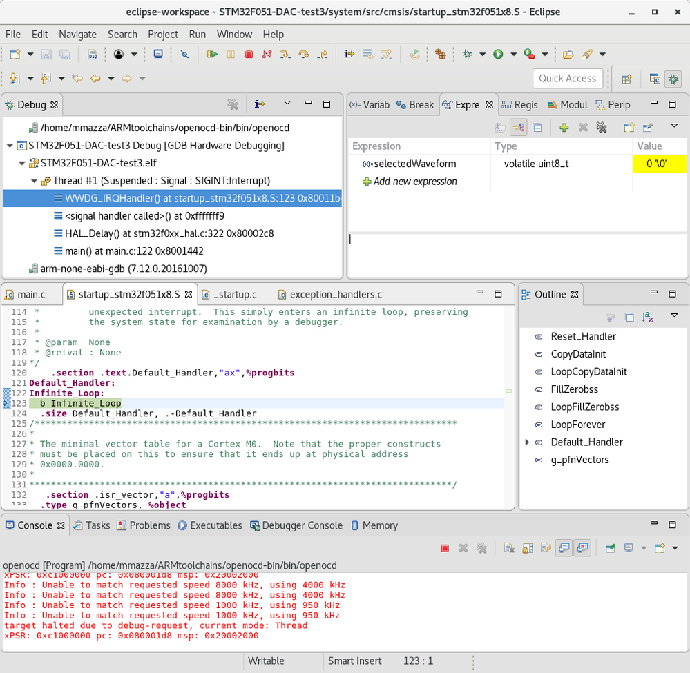

Unexpectedly, the call to HAL_Delay (10000) causes the blocking of the program, causing it to jump into an infinite loop as can be seen from the screenshot below:
The code is relatively simple, compile without errors, flashes correctly and I can trace it in debug mode in the usual manner.
I'm experimenting with and STM32F0Discovery board. and I'm using Eclipse with arm-none-eabi-gcc toolchain under Debian linux, and GNU MCU Eclipse plugin.

I 'm really don't know why the program hangs in an infinite loop when calling HAL_Delay().
The WWDG_IRQHandler() is called, but I never activated the watchdog module in no way...
Am I doing something wrong?
No, you have a fault, probably hardfault; it's just that you don't have a separate handler for hardfault nor for the WWDF interrupt handler so both use the same default handler.
MMazz.11
HardFault_Handler() is implemented in stm32f0xx.c . I've tried to implement WWDG_IRQHandler() also amd put breakpoint in both.
Execution do not halt when an exception is encountered after the HAL_Delay() call.
The program stucks in default handler, and the stack this shows "<signal handler called>() at 0xfffffff9.
I've tried to raise the default values of __Main_Stack_Size and _Minimum_Stack_Size (in file sections.ld) with no results.
I'm really puzzled.
Max
Is it using a TIM or SysTick for the clock?
Do you have an IRQHandler for either?​
Clive,
You pointed me in the right direction.
A careful examination of the file stm32f0xx_it.c shows that the SysTick_Handler was correct:
void SysTick_Handler(void)
	HAL_IncTick();
that is used by HAL_Delay() call in my main.c .
But I forgot completely to implement the following: :expressionless_face:
void DMA1_Channel2_3_IRQHandler(void)
  HAL_DMA_IRQHandler(DacHandle.DMA_Handle1);
So, after the first transfer, the DMA never was serviced and because that, an hard fault was generated, I presume....
Now the program works perfectly. My brain a little less. I got a headache !!!!
