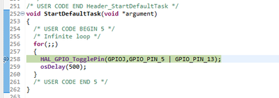

Attached a project where the on board (STM32F769I-DISCO) LEDs are toggling in the default task.
I can set a break point and reach the GPIO toggle here:
void StartDefaultTask(void *argument)
  /* USER CODE BEGIN 5 */
  /* Infinite loop */
  for(;;)
    HAL_GPIO_TogglePin(GPIOJ,GPIO_PIN_5 | GPIO_PIN_13);
    osDelay(500);
  /* USER CODE END 5 */
Hope that helps

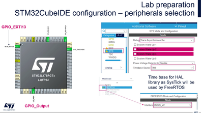

Did you select another timeer for the system (HAL) and kept the FreeRTOS time base with the system tick?
See this video: FreeRTOS on STM32 v2 - 01 Preparation - lab
Slide at @4:05 it indicates that the "Time base source" needs to be changed to another timer like TIM6 and System tick needs to be reserved for FreeRTOS scheduler time base:

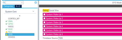

Yes I did take care of the Timers in a similar fashion to that shown in the video.
The difference being my debugger shows the only viable option as Serial Wire and all wakeup selections are highlighted
But, I will re-do them just to be sure.

Thanks for the application example.
It compiled and runs just fine.  Still no breakpoint trigger in default task routine.
this seems so very strange....  maybe I'm just doing something wrong setting the breakpoint.
This is more or less grasping at straws at this point.  Now i'm looking for things i may be doing differently.
  1. how do you set your breakpoint (Mouse, Keyboard, other?)
  2. are you setting a specific kind of breakpoint? I have tried regular and hardware
Apologies for all the hassle.  Thought this was going to be a simple thing but now i'm not so sure.
