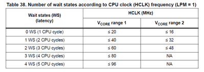

  4. Additional Best Practices:
Illustrations:
  • When Flash low-power read mode LPM = disabled:
  • When Flash low-power read mode LPM = enabled:
Please feel free to respond and confirm whether this resolves your request or not.
Best regards,
Haifa.
