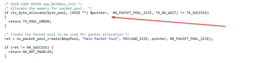

Dear @Walid ZRELLI​ ,
thanks for checking this topic again. This answers my question almost complete. The only thing I would like to know is if there is an example how to separate the buffers.
As I understand NetXDuo all packets (TCP & UDP) are put into the "packet pool".
  • a. Is this correct?
  • b. If so would it be enough to separate this section here in the code into an none-cachable region?
0693W00000GWQqGQAX.pngBest regards,
Eric
Hello @ESawa.1​
  • a. Yes correct.
  • b. We didn’t try, but, yes, it should be correct.
We don’t have/provide an example using split of the packet buffers.
BeST Regards,
