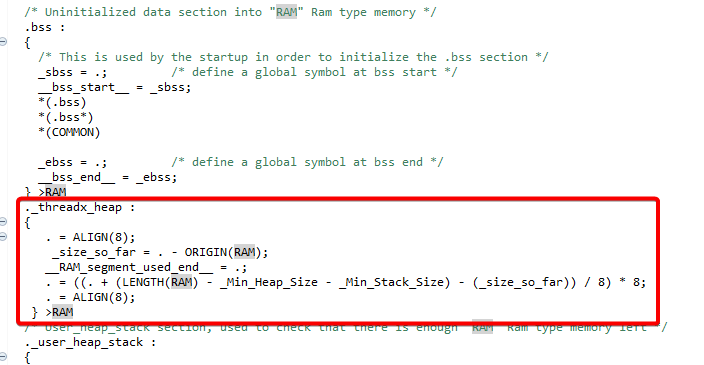

For those who are facing the linker error using STM32CubeIDE:
tx_initialize_low_level.S:521: undefined reference to `__RAM_segment_used_end__'
It turns out that CubeMX does not change linker files as per procedure in this link:
x-cube-azrtos-h7/Projects/STM32H735G-DK/Applications/ThreadX/Tx_FreeRTOS_Wrapper/README.md at main · STMicroelectronics/x-cube-azrtos-h7 · GitHub
While the procedure are intended for x-cube_azrtos-h7, I used it for my STM32U545 project because I have not find any other option!
I have tried to implement whatever mentioned in the guide and could get the project built successfully.
The guide suggests adding a section between .bss and ._user_heap_stack. it suggests a fixed size, but I tried to let this new section allocate all unused RAM:
  ._threadx_heap :
     . = ALIGN(8);
      _size_so_far = . - ORIGIN(RAM);
     __RAM_segment_used_end__ = .;
     . = ((. + (LENGTH(RAM) - _Min_Heap_Size - _Min_Stack_Size) - (_size_so_far)) / 8) * 8;
     . = ALIGN(8);
   } >RAM

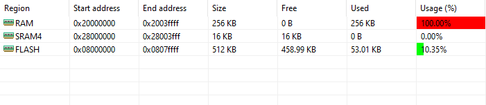

And this caused RAM to be 100% used as shown in build analyzer:
