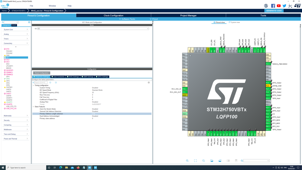

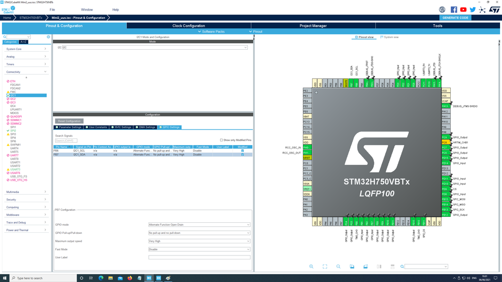

0693W00000BaDTlQAN.png0693W00000BaDTgQAN.pngI get HAL_error from I2C calls. I have not tried HAL_I2C_IsDeviceReady. (I also noticed that breakpoints do no work with CubeIde and stm32h750vbt6, and then I read that some CPU had that problem.)
I get good square wave from SCL and SDA pins, I can't tell you more now, I have only single channel scope here. Pictures show CPU/CubeMX settings, I cannot anything special in them.
If they return HAL_ERROR, it would indicate your device does not ACK when the address is sent.
So try it. This should be the first step in debugging an I2C problem. If you don't get HAL_OK, the device isn't wired up properly, or doesn't have the slave address you think it does.
LMI2
Lead
HAL_I2C_IsDeviceReady returns error at every address except at 00h. I think I must check my ADC.
