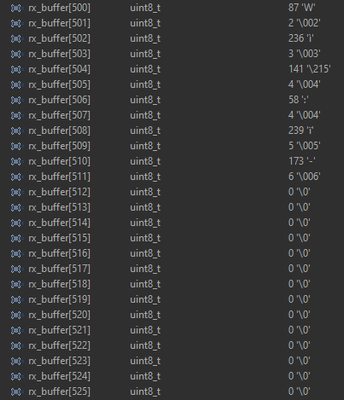

Hello, I am having a issue with HAL_UARTEx_ReceiveToIdle_DMA on a NUCLEO-H7A3ZI-Q, when using the following code:
uint8_t rx_buffer [4096];
HAL_UARTEx_ReceiveToIdle_DMA(&huart3, rx_buffer, sizeof(rx_buffer));
void HAL_UARTEx_RxEventCallback(UART_HandleTypeDef *huart, uint16_t size){
 /*code*/
 My rx_buffer is only populating the first 512 bytes, with the remaining data remaining as 0.
__HAL_DMA_GET_COUNTER(huart3.hdmarx);
Provides the incorrect amount of data being passed over serial.
I have used serial plotter and CoolTerm to try and send packets but both hit this 512 byte limit.
rx_buffer not populated past 512 bytes
length correctly calculated as 640 bytes long

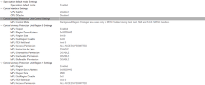

This looks like a cache issue. You will need to disable data cache or manage it appropriately. Invalidate after data is received but before reading it.
How many bytes are you expecting to receive? 640?
PincateAuthor
Feb 18, 2026 3:30 PM UTC
Thank you,
In the attached instance I was expecting 640 bytes + 5 confirmation bytes. However I want to send payloads up to 4096 bytes.
I have mapped the MPU to match the memory areas from the linker script
MEMORY
 ITCMRAM (xrw) : ORIGIN = 0x00000000, LENGTH = 64K
 FLASH (rx) : ORIGIN = 0x08000000, LENGTH = 2048K
 DTCMRAM1 (xrw) : ORIGIN = 0x20000000, LENGTH = 64K
 DTCMRAM2 (xrw) : ORIGIN = 0x20010000, LENGTH = 64K
 RAM (xrw) : ORIGIN = 0x24000000, LENGTH = 1024K
 RAM_CD (xrw) : ORIGIN = 0x30000000, LENGTH = 128K
 RAM_SRD (xrw) : ORIGIN = 0x38000000, LENGTH = 32K
 Should I disable the MPU during hard faults? Is there anything else standing out.
This is how each region is configured.
Region memoryInstruction accessShareableCacheableBufferable
ITCM RAM (0x0000 0000, 64 KB)EnabledNot shareableNot cacheableNot bufferable
FLASH (0x0800 0000, 2 MB)EnabledNot shareableCacheableNot bufferable
DTCM RAM 1 (0x2000 0000, 64 KB)DisabledNot shareableNot cacheableNot bufferable
DTCM RAM 2 (0x2001 0000, 64 KB)DisabledNot shareableNot cacheableNot bufferable
AXI SRAM (0x2400 0000, 1 MB)DisabledNot shareableCacheableBufferable
SRAM_CD (0x3000 0000, 128 KB)DisabledNot shareableCacheableBufferable
SRAM_SRD (0x3800 0000, 32 KB)DisabledShareableNot cacheableNot bufferable

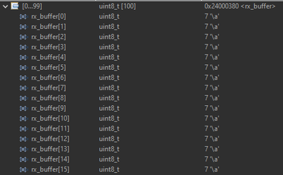

Initialize the array to something unique/nonzero so you can see if bytes 512-640 are actually written.
PincateAuthor
Feb 19, 2026 12:16 PM UTC
I added the following script to replace all of the rx_buffer values with 7:
for (uint16_t i = 0; i < 4096; ++i) {
	rx_buffer[i] = 7;
Whilst rx_buffer is initially fully populated with 7's, by using breakpoints I can see that it is not updating to match the information sent over serial when the following interrupt is triggered.

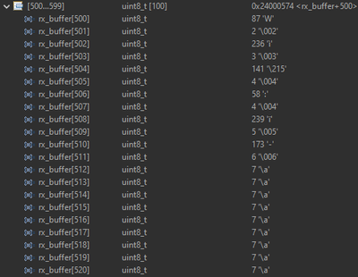

PincateAuthor
Feb 19, 2026 12:40 PM UTC
Sorry, update to this; by changing the way I populated the rx_buffer in the while loop I have achieved the screenshots below. suggesting the issue still lies with how the rx_buffer is populated and not the transfer to the look up table.
while (1) {
	if (mode == 0) {
		if (rx_buffer[0] == 0) {
					rx_buffer[i] = 7;
 / code /
payload had length 640, yet only the first 512 bytes of rx_buffer were populated (including [0]).
The LUT is correctly populated from the rx_buffer with uint16_t based on the uint8_t captured in rx_buffer. this stops working at the 254 value as the 5 start bits account for the remaining values to reach 512 bytes. Each subsequent value is populated as 0x0707=1799 all the way to 319 as requested.
