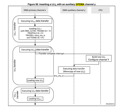

I believe that would only work for the internal ADC. Sorry I should have clarified that it is an external ADC that sends a DRDY back to the MCU when the conversion is completed. (Conversion is handled internally to the ADC). What I have been trying to do is use the DMA LL architecture to do the following.
1. Configured DMA:
- Circular mode
- First node has a trigger from external interrupt
- basically a dummy node that does no real transfer
- second node triggers a RX for 4 bytes from the ADC using SPI (SPI1)
- trigger an interrupt stating the conversion has been completed or increment the location of the next message so that I could do a burst of 50000 transfers in a buffer before handing off to the main loop for further processing
Thus far I am unable to get the SPI message to trigger using this approach. I am able to see clock signals if I manually start the SPI message using the HAL_SPI_Receive_DMA(&hspi1, data, 4); command or by manually changing the SET_BIT(hspi1.Instance->CR1, SPI_CR1_CSTART);.
Thus far I am unable to get the DMA to cause any SPI message to be originated head-lessly from the DMA. I have also tried using a 1 node chain for the LL that is the SPI RX that contians the trigger but reading the User Manual it seemed like a n-1 node was required for the pause to execute correctly. (User Manual RM0456 698 - 700)

I have been trying to work through the messaging similar to the STM32U5 workshop: STM32U5 Workshop (rristm.github.io).
I have been able to get the USART working as they show but I cannot get the SPI to work in a similar manor. Do you know if there is something special about the SPI protocol or controller that prevents this type of architecture?
‎2024-05-14 11:02 AM
Do you want to read out like Figure 8-35. SDO/DRDY and DRDY Function?
Have you tried to use EXTI(DRDY) as trigger for a SPI transfer of 24 bit and SPI_RX_DMA to write the result to a block of memory?
