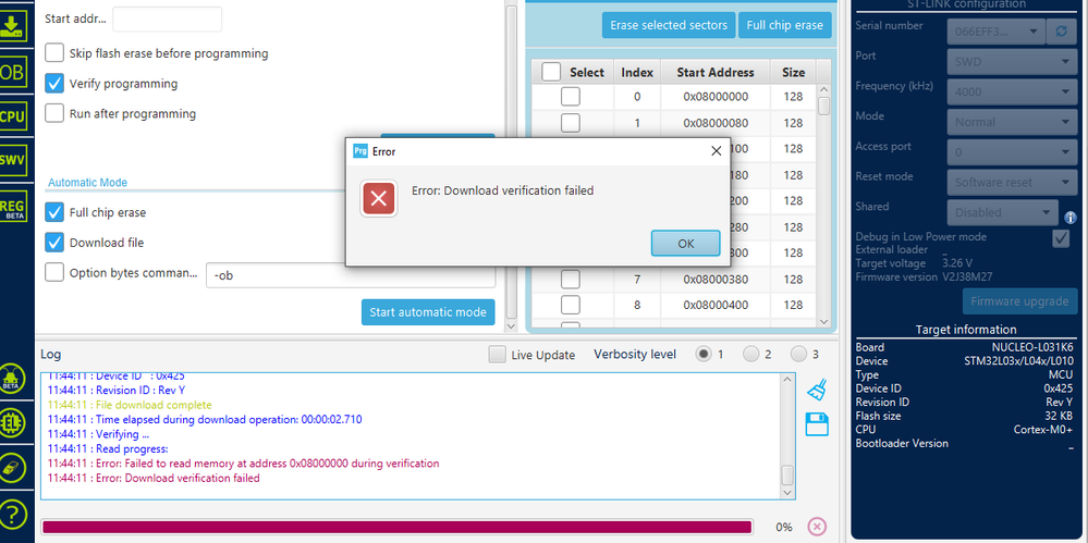

With ST-link V3, is there an option to verify while programming like in ST-link V2?
FArdi.1
MCU is STM32L0.
The file I use to program has option bytes added with read-protection turned ON.
:020000041FF8E3
:0C0000000000FFFF7A80857FFF0000FFFA
:00000001FF

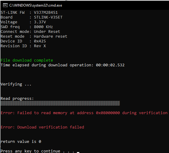

Using ST-link V3, I'm having this error: (see attached screenshot)
Command line:
stm32_programmer_cli -c port=SWD freq=8000 mode=UR -d "%FILE%" -v
It was ok if I use ST-link V2 with this command:
st-link_cli -c SWD FREQ=4000 UR -P %FILE% -V while_programming

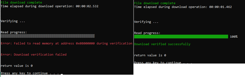

Hi @FArdi.1​ ,
Yes I confirm, verify option while programming is removed from STM32CubeProgrammer.
The verification is done after programming.
Houda

Mike_ST
I don't know such an option in STM32CubeProgrammer,
As you noticed, the verification is done after programming, so you'll have to set protection after verification.
I just notice that the issue seems not about hardware (V2 or V3), but ST-link utility vs CubeProgrammer.
I used back V2 with CubeProgrammer and same hex file. Verify failed. It was working on ST-link utility (because it can verify while programming)
Thanks for your your suggestion to workaround this issue, but I can't use it until we have reliable return code (now: success and failed always return zero).

Do you mean the feature is available in ST-Link V3 hardware, but cannot be activated by STM32CubeProgrammer?
To avoid misunderstanding the title, I clarify again my intention.
The issue is about missing these two options:
1) while_programming
2) after_programming

Hi @FArdi.1​ ,
Houda
Any plan to put that feature into STM32CubeProgrammer?
If not, do you have any suggestion on how to verify programming with file that has read-protection setting in it?
