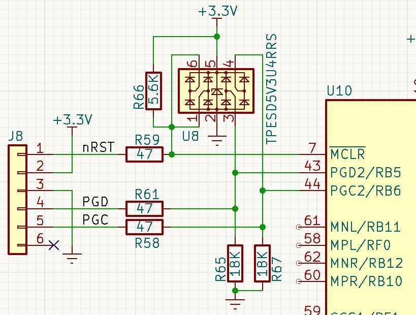

As for 22 ohm. I have implemented this programming interface in the PIC world for a couple of decades now. I've learned that the STM32 will not require the two 18K pull downs, their internal on the F030.
Makes the interface pretty much indestructible to human body model surge.
Thank You
0693W00000Su1xmQAB.jpgSorry Harvey
I dropped a .jpg of the interface discussed but obviously the machinery removed it.
I will try again here.
Although it appears to work, drag and drop does not work. One must use the image button.
Whooda thunkit.

The 22 ohm resistors are in series with the connection from the processor to a number of things:
1) the programming interface
2) the QSPI memory (AP6404L connected to the QSPI interface on an L5 processor. Not all processors support this)
3) the FMC interface to an S1D13517 (Epson) graphics controller chip.
4) a clock line or so (for the S1D13517).
Note that these are not pullups or pulldowns, but are included to damp reflections on the lines, and form a small low pass filter for possible ringing. If you check the designs on say, some of the disco boards, you will see that they do much the same thing. It may reduce the need to length match some of the data lines on the faster signals. It does work (didn't try without it) on the QSPI memory lines. The price of 22 or 33 ohm resistors (0402) is so small that a thousand of them is almost a throwaway.
The boards are 4 layer boards with a ground plane and 3 other planes (slightly complex board), and the signals seem reasonably well behaved.
You can argue whether or not the resistors are needed on the programming pins, but I rather suspect that they are needed on some of the other lines (such as FMC signals).
