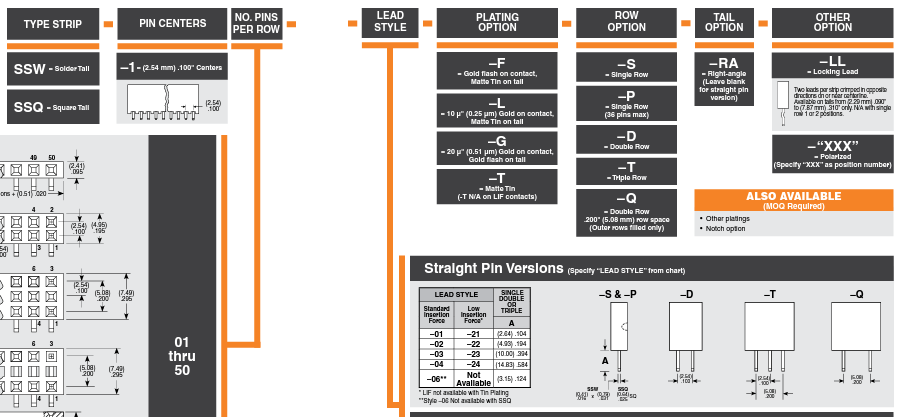

I looked on my Nucleo L5 BOM ( https://www.st.com/resource/en/bill_of_materials/mb1361_bom.zip )
and found some Samtec SSW-1xx-23-x-D.
The datasheet is here: https://suddendocs.samtec.com/catalog_english/ssw_th.pdf
and the "23" in the part reference indicates some low insertion force 10mm pins
CN8 Socket, 8x2, 2.54mm, VR, TH, Height 8.51mm/10mm, Low insertion force SAMTEC SSW-108-23-x-D
CN7 Socket, 10x2, 2.54mm, VR, TH, Height 8.51mm/10mm, Low insertion force SAMTEC SSW-110-23-x-D
CN9 Socket, 15x2, 2.54mm, VR, TH, Height 8.51mm/10mm, Low insertion force SAMTEC SSW-115-23-x-D
CN10 Socket, 17x2, 2.54mm, VR, TH, Height 8.51mm/10mm, Low insertion force SAMTEC SSW-117-23-x-D
CN11, CN12 Header, 35x2, 2,54mm, VR, TH, Height 5.84mm/2.54mm SAMTEC TSW-135-07-x-D Not Fitted 0
Might be custom order, where the x is flexible. Perhaps talk to you local ST FAE, or SAMTEC
x is the plating of the pins
For the NUCLEO-144 boards, check out Samtec TSW-135-09-G-D.  It has the same long pins as the NUCLEO-64 boards.  Style "09" defines pin length:
5.84mm  (.230") above connector
2.54mm  (.100") connector itself
10.16mm (.400") under connector
Assuming board thickness of 1.78mm  (.070"),  length of pin under the PCB would be 8.38mm (.330")

The NUCLEO-144 pin boards do not have the CN11 and CN12 morpho connectors populated.  I have been looking for parts to populate these "missing connectors".  I really like the morpho pins on the Nucleo-64 boards, allowing me to connect parts to the top side and attach instruments to the bottom side of the board.  The BOM for the Nucleo-64 boards indicates a "Lyconn 313238S161185", but this part is hard to locate.  The Samtec TSW-135-09-G-D appears to be a close match.
