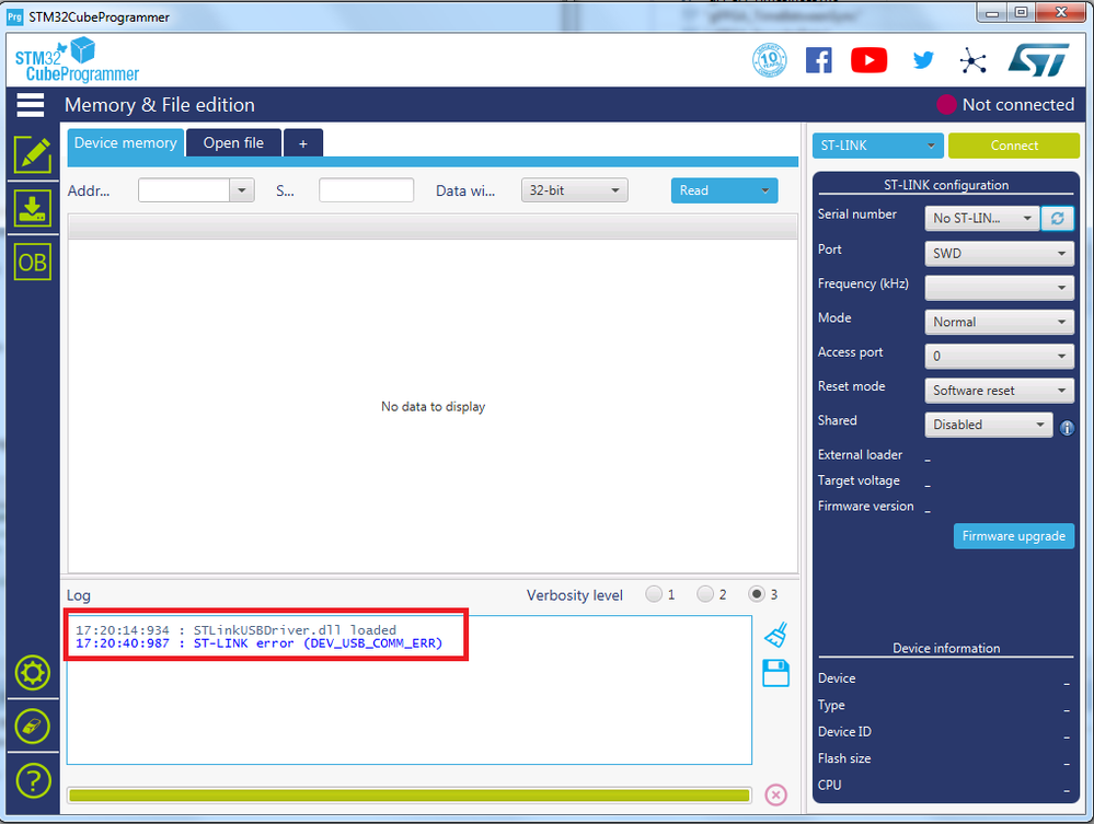

1) The USB connection is flaky: When I try to refresh the connection, or connect to the target, frequently it loses the USB connection and I have to either unplug or disable/renable the device to reconnect. See below: The first connect succeeded, and then I get a DEV_USB_COMM_ERR when I try to refresh. When using the EVAL board I can refresh the connection with no issues.

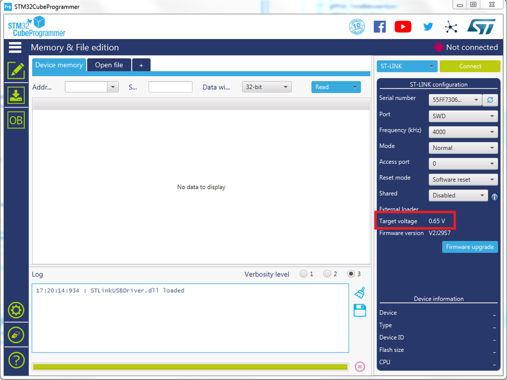

2) The board voltage is incorrect. With the eval board, I see the target voltage of ~3.3V. With the dongle, I've seen anything from 0V to 2.2V, but never 3.3V. I have measured the voltage in the ribbon cable going into Vcc at 3.3V, so I'm not sure why the dongle doesn't see it. In the image below, the ribbon cable is completely disconnected but the target voltage is non-zero:

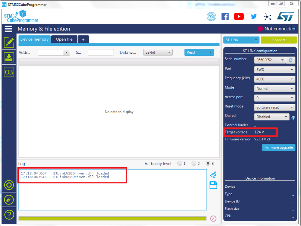

For comparison, here is an example where I'm connected to the eval board. You can see that the voltage is correct and a refresh worked fine:

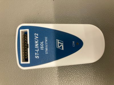

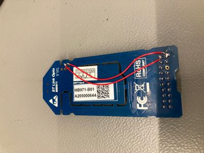

‎2023-08-01 1:11 AM
  Just connect those points(3.3v and gnd) , then it will work
‎2025-02-10 6:18 PM
Arun Natarajan you just made my day, I was experiencing problems when trying to connect on a stm32 with swd connectors. I noticed I have exactly the same model of st-link/v2 (isol) dongle.
Given the wiring proposed I finally managed to download my bootloader on the chip.
I just wondered if this may interfere with other connector types. Maybe after all I should have just given 3.3v and ground to the two pins with jumper wires.
Anyways for now this did the trick.
