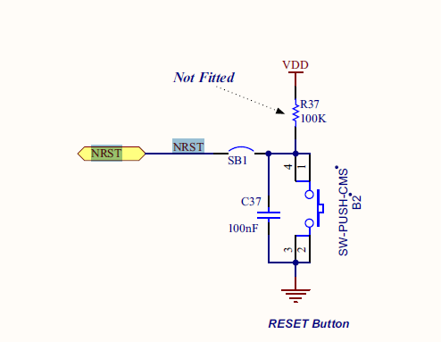

What does it mean not fitted: User manual Discovery kit with STM32F407VG MCU?
Test User
1 REPLY 1
waclawek.jan
It means, the resistor is not present on the board as it is sold. The pads for the resistor are there, so you can decide to place it, if you want.
