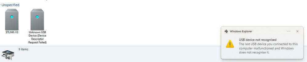

i am just trying to send the data to computer, USB Detected but , it shows up the "USB Device Not Reconized"
what  should i do?
I have attached a screenshot for your reference, along with the programScreenshot 2024-09-06 131620.png

Hello @Berlin-raj123 ,
Make sure that all the drivers are installed and that USB connections are correctly made: PA11 (USB_DM) and PA12 (USB_DP) should be connected properly.
Make sure to configure the system clock to the correct frequency.
Did you try to follow and test the USB CDC example project provided in the STM32CubeG0 firmware package:
STM32CubeG0/Projects/STM32G0C1E-EV/Applications/USB_Device/CDC_Standalone at master · STMicroelectronics/STM32CubeG0 · GitHub
Please have a look at this FAQ, this may help you: USB device not recognized - STMicroelectronics Community
