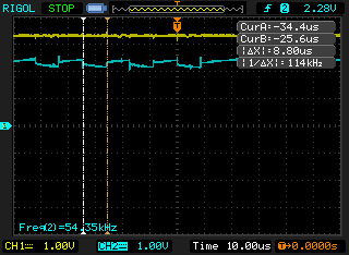

All my code is doing is transmitting a continuous stream of "U" characters, which I would expect to produce a square wave with a frequency equal to half the baudrate and an amplitude of 3.3 V. That's exactly what it looks like on the RX line when I send U's via RealTerm and probe between the MCU and the FTDI Basic. But when I probe the TX line, it shows a DC offset of about 2.20 V and an amplitude of about 0.24 V (Figure 1). Why?
I tried another test, disconnecting the FTDI Basic from the MCU. When MX_USART1_UART_Init() runs and initializes the internal pull-up resistor on PA9, the voltage jumps to 3.3 V relatively fast. But when I disconnect power from the board after this occurs and before main() runs, the voltage on PA9 gradually drops toward zero, as if there were a capacitor on PA9 (Figure 2). Repeating with the FTDI Basic results in the same effect, but with a DC offset of about 1 V.

Blue is PA9 and yellow is PA10.
Figure 1: Transmitting "U" stream
Figure 2: Powering down from 3.3 V

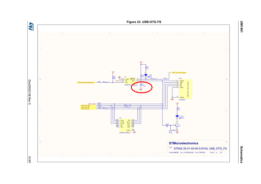

Perhaps review the schematic? Doesn't PA9 conflict with VBUS? And have 5V driven on it? Perhaps drive PH5 low https://www.st.com/content/ccc/resource/technical/document/user_manual/25/21/69/1d/13/c5/4e/c9/DM00036746.pdf/files/DM00036746.pdf/jcr:content/translations/en.DM00036746.pdf
In my setup I followed Table 20 of the eval board's user guide (UM1461), which says to "Remove USB cable from CN8" and "Remove R18" in order to disconnect from VBUS_FS.

waclawek.jan
This is a known problem, the same is on the 'F4 DISCO, and we've discussed it here since maybe 2013 or so, so I'd expect it to be already part of the manual...
