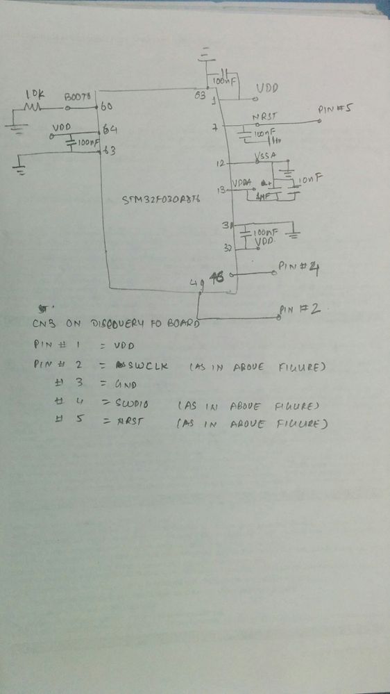

Greetings People,
I am trying to program my target device STM32F030R8 using Discovery F0 Board. I have removed CN2 jumpers and connected my target device to CN3 pins♯ 1,2,3,4,5. I have left out pin 6 which is not required. I am have written program in Keil MDK Arm. When ever i try to Download program from Keil to my target device , it says target not connected.
Any help would be appreciated.

‎2017-09-16 5:05 AM
Suggests the target board is non-functional, review design and connectivity, especially power and reset. Provide details like the schematic for the board/connectivity.
‎2017-09-17 10:57 PM
Greetings Clive,
I have connected my application STM32F030R8T6 to STM32F0 Discovery board in the below manner. Sorry for bad writting.
