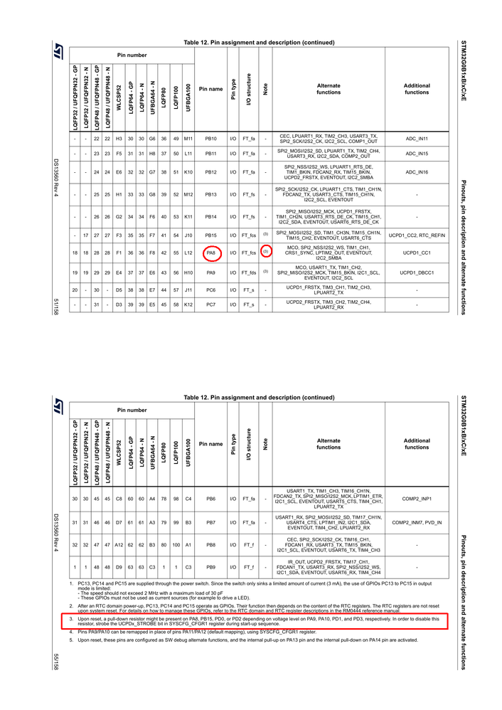

I have been up and down the code and can't seem to find anything that could be causing this or that I'm doing wrong. I used an oscilliscope to check the output wave forms for the A and B lines and they both looked as expected for a quadrature encoder. The only thing I found was that the A line was lower than the B line, measured on the encoder pins to ground. Channel B was 3.3v as expected but channel A was just 2v. After removing parts systematically to find the issue I found that none of the resistors or capacitors were faulty but that the fault appears to be within the micro. After completely lifting that pin (PA8) from the circuit, I could measure a resistence of 5k ohms from that pin to ground when the micro was running. This makes sense with the voltage measurements I was getting; ~.6v at the micro pin and ~2v at the encoder.
So it seems my micro is pulling the pin down with a 5k resistor or something and I can't figure out why. As far as I can tell the pull ups and downs are 40k anyway so it can't just be that. It is only affecting the one pin, not the other timer pin. I don't even know if this is what my issue actually is or if I'm just chasing my tail but it's the only thing standing out that I don't understand.

This is the infamous USB-C PD Dead-battery gotcha.
After you disabled the pulldown, if the encoder still does not work, read out and post the TIM and relevant GPIO registers' content.

This was it, thank you! That's what I get for not reading the note, lesson learned!
