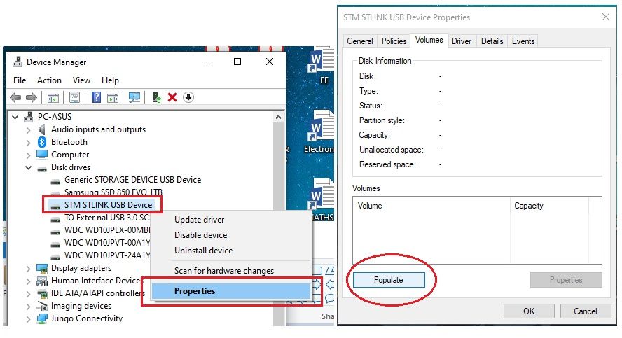

The new unit of STLINK V3SET received on 17/2/2021,
- Cannot performs "Firmware upgrade" under STM32CubeProgrammer
- Cannot "populate" its flash disk, 0MB, hangs for long time

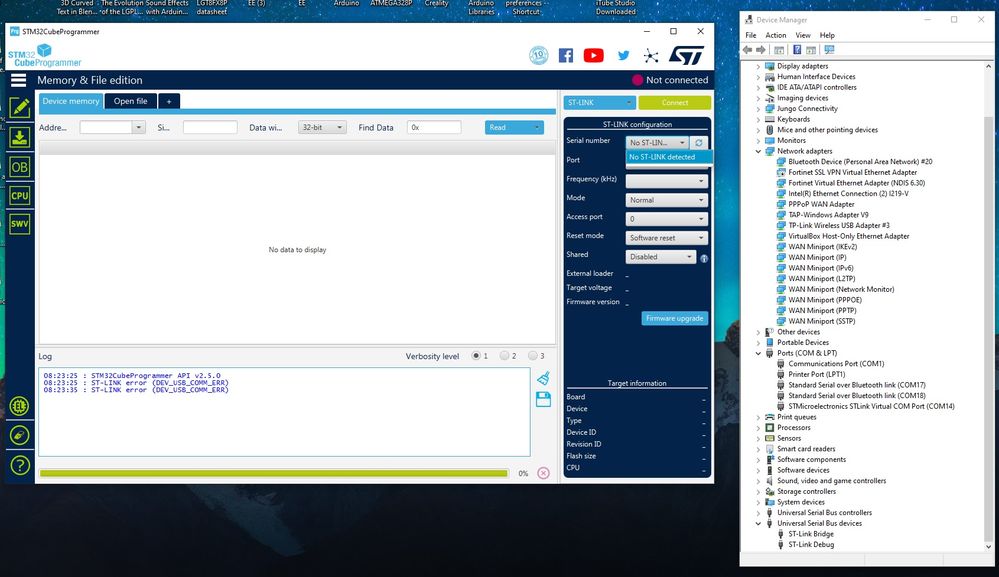

- Cannot connect even via UART option under STM32CubeProgrammer

Why does it need to populate? It is designed to provide a simple drag-n-drop for a binary file.
- There is no physical USB disk drive of 1MB that allows me to drag-n-drop files as per your mentioned.
Why would it connect as a UART?
- Since STLINK is not detected but it has its COM port detected, so I try connect it via COM14 as shown on the picture, merely for trial-n-error.

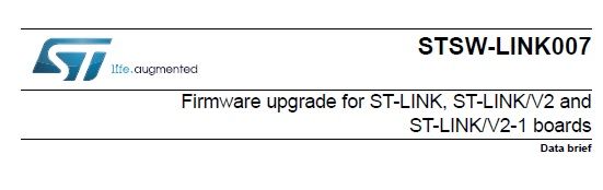

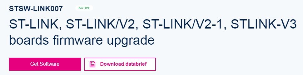

- en.stsw-link007_V2-37-26 - To upgrade firmware for ST-LINK V2, V2-1 only, you sure can be used for ST-LINK V3SET ?

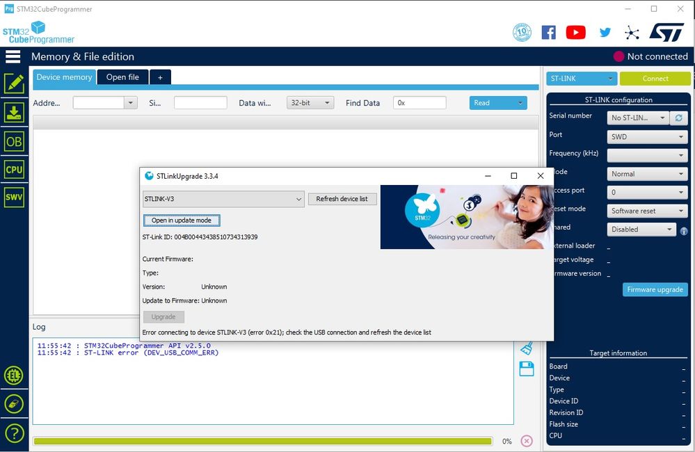

- Tested using STLINK UTILITY, unable detect as well and standalone STLINK Upgrade.

Thanks for the hint, actually I referred to the databrief PDF document which I downloaded on 16/2/2021, even now if you clicked on the "Download databrief" button, the document title is stated like picture shown below, that's why is confusing me:

hi, here are what I found:
- After plugged in directly to a standalone USB port ( none USB HUB ), the flash drive shown up, the Firmware upgrade is done and upgraded to version V3JM2B4S1 either under STM32CubeProgrammer or STSW-LINK007.

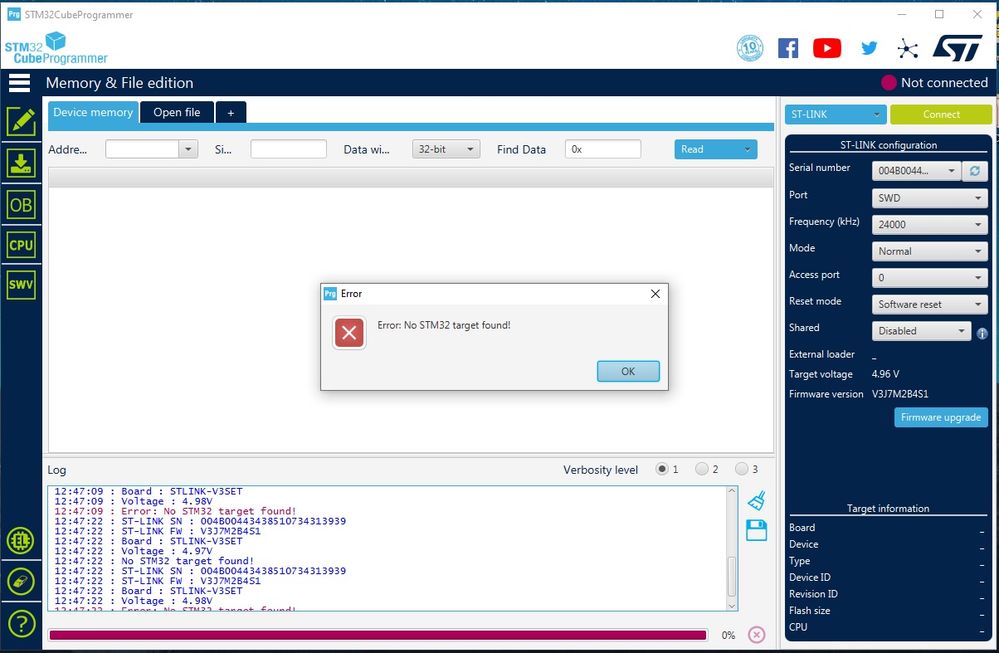

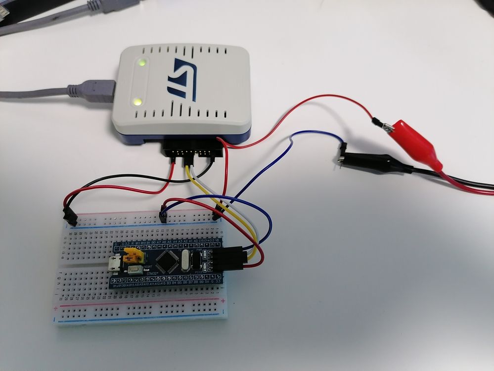

- However, I am still unable to establish a connection via STM32CubeProgrammer with the following configuration, the target MCU is STM32F103C8T6, I have pressed the RESET button then the "Connect" button, still failed.
- Please advise if there any error on connection ? ( I am using +5V DC external power input to power up the STM32F103C8T6 via its SWD interface ( Yellow is SWCLK, White is SWDIO ) and external +5V to Pin1 T_VCC, GND to Pin20 of CN2 JTAG connection ).

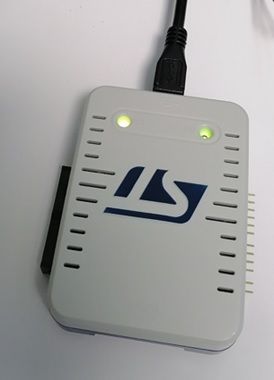

- I noticed from the datasheet mentioned the COM is Red color, but sometime when I powered up the STLINK V3SET it auto turned to GREEN any reason but often is Red color always ?
Please advise.

Can you please try to use STLink utility instead of STM32CubePRogrammer to confirm if issue is related to CubePRogrammer or STLINK V3SET?
Try also to decrease the frequency to 3300 KHZ and tell me if you are able to connect?

If you use only tested agaonst a bluepill as target. keep in mind that a lot of clone float around and STLINKV3 only connects to genuine STM devices.

Yes, I used STLINK Utility and successfully updated to latest firmware for STLINK V3SET.
I also changed the frequency to 3300 kHz that time because STLINK V2 at 4000kHz works, but for STLINK V3SET 3300kHz, it failed to establish connection to the target STM32F103C8T6 clone board.
