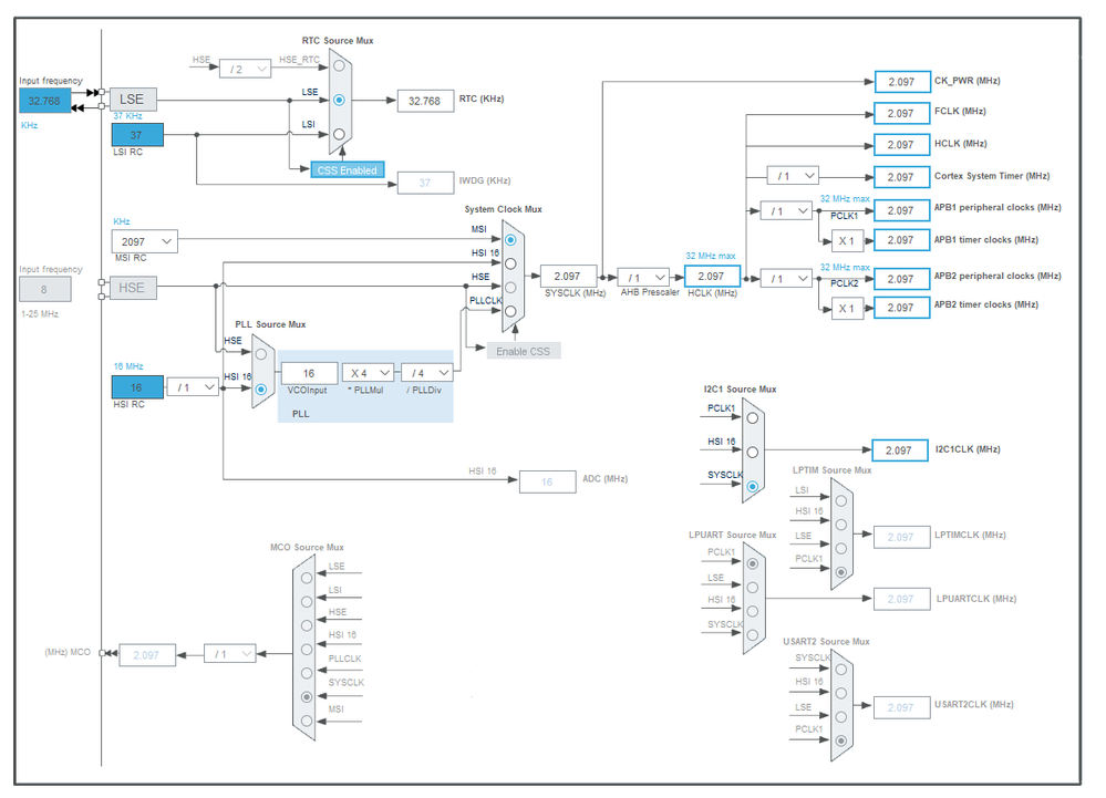

it seems my project hangs at this line ?
  Error_Handler();
What could be wrong?

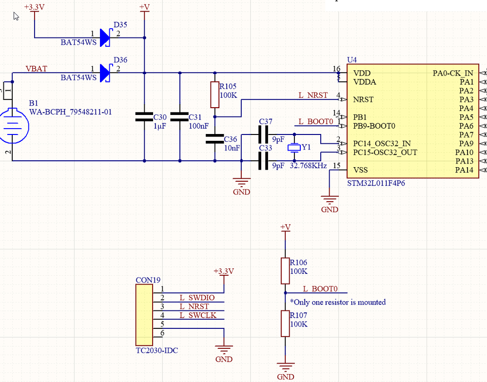

Is this a custom board or known good hardware? Seems like you have a problem with the LSE connection.
You can try increasing the timeout value (LSE_STARTUP_TIMEOUT) to tens of seconds to see if it helps.
Edit:
Also, "hangs" is ambiguous. It is expected that the LSE will take some time to become stable. Does it return successfully after a few seconds or does it fail and return HAL_TIMEOUT?

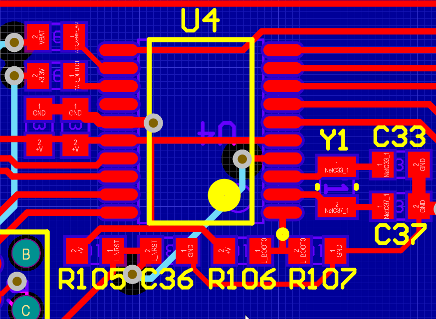

Its a custom board, i will show the schematic and PCB design.

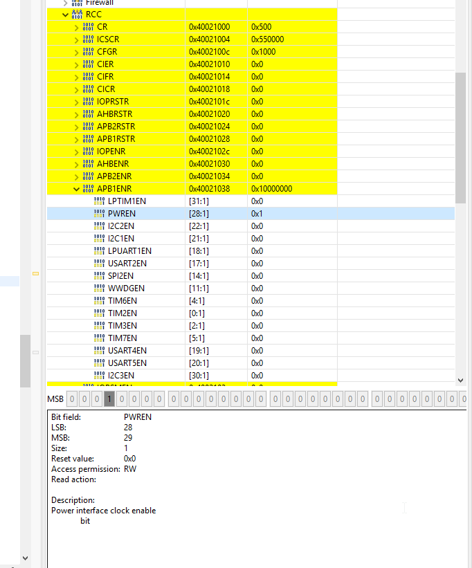

Is there a write to the DBP bit before the snippet you've posted?
Read out and check if RCC_APB1ENR.PWREN is set.
There is a write to PWR_CR_DBP before the snipped i posted, but the bit refuses to set
I notice that the external xtal is not running, (measure nothing on scope), does this have influence at that point of the initialisation?
Wondering why i dont measure anything, as this is a recommended part by STM. I have tried all "LSE drive capability settings"...
