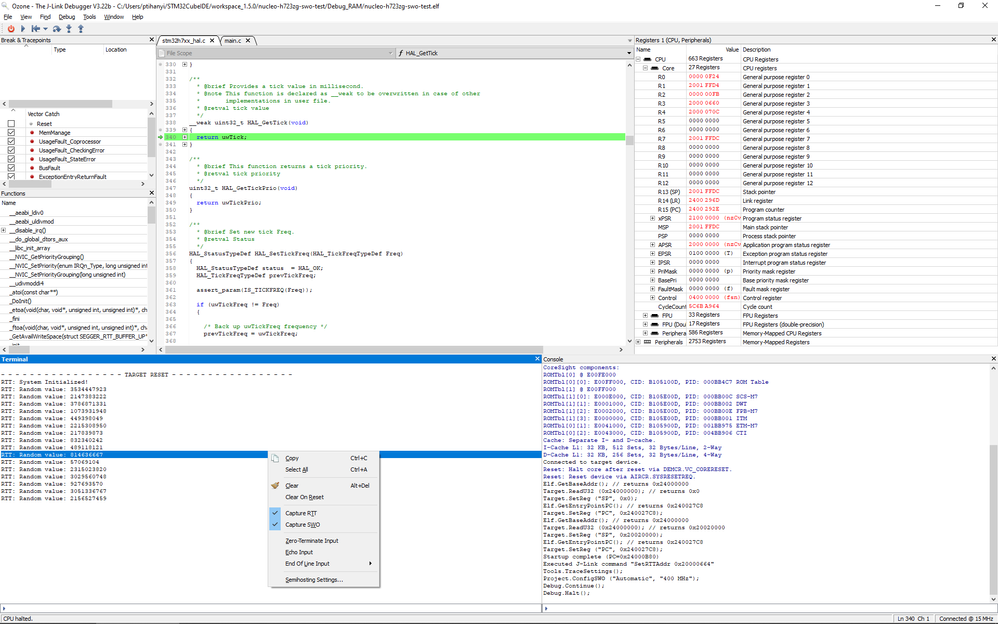

Although I only use ITM channel 0, DWT-Comparator data is displayed in LOG ... ???
The MCU clock is 400MHz and the SWO divider has also been carefully set.

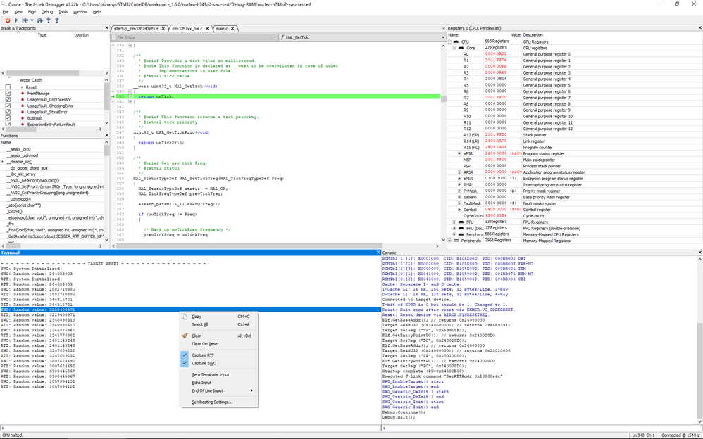

I did the same project on a NUCLEO-H743ZI2 board (the newer ST-LINK/V3 release) and it works perfectly with ST-LINK/V3 and J-Link EDU as well.
I extended both projects with SEGGER RTT printf and tried to debug with Ozone:Only RTT is visible with NUCLEO-H723ZG, SWO also works with NUCLEO-H743ZI2.

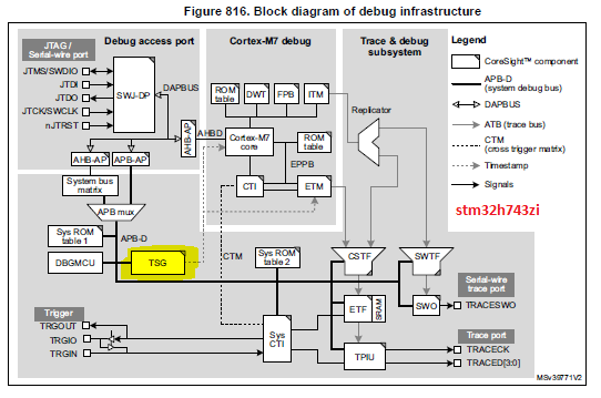

The debug infrastructure block diagram shows that TSG is missing from STM32H723ZG.
There are other differences too. Can these differences cause that problem?
