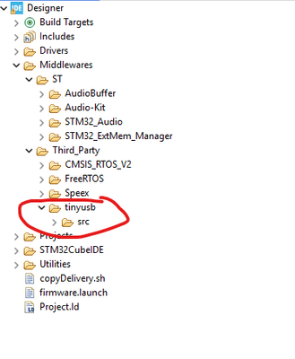

Visitor II
December 8, 2025
Hi Jonathan,
Yes I see the presence of tinyusb in X-CUBE-AUDIO-KIT. But in one project (Livetune) for STM32N6570-DK, tinyusb is not used.
December 8, 2025
Here is a print screen of latest v1.4.1, tinyUsb is there for STM32N6570-DK and the USB enumerates properly.
What do you mean when you say it is not used?
You open a project and see no code or the USB is not working as expected?
