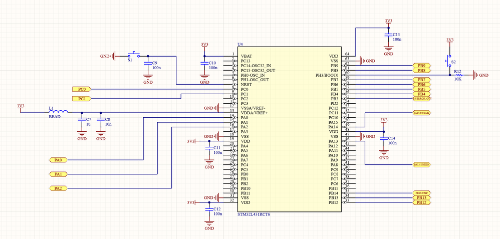

Hello all,
I am using STM32L431 in this project, and I have made a prototyping board for it. However, the MCU will not communicate with the debugger.
Below is MCU part of schematic:
Only SWDIO and SWCLK are connected to the debugger. The MCU is powered seperately by an on board LDO.

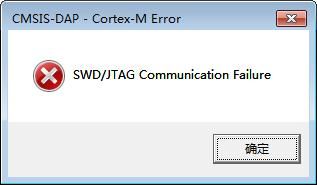

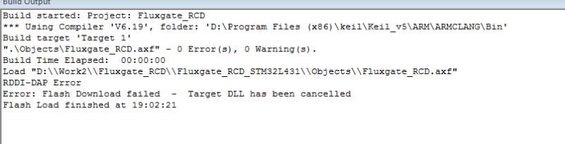

Error message:
I tried to reset by pressing S1 after powering up, but that did not work.
I initially left VDDA unconnected to 3V3 while all VDDs are connected to 3V3, by not mouting BEAD L1. Now the L1 pads are shorted with solder. Could this have damaged the MCU?

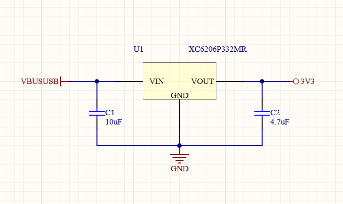

Power supply schematic:
The typical design of this LDO suggested using output capacitor of 1uF, while I am using 4.7. However, they did mention that using output capacitors larger than 1uF is possible.
Please help! Thanks in advance!

Hi @ZJing,
is GND connected to the debugger as well? If not, this is probably the issue...
Concerning the VDDA, the damage of the MCU cannot be ruled out... But otherwise I do not see any issues with the power supply and the decoupling.

Basic electronics dictate the need for common grounds. You're creating a circular path. You can have different supplies, but they need the same basis.
VDDA powers POR and PLL, not just ADC/DAC.

>>Does this mean that if VDDA is not connected to 3V3 and instead is floating, the MCU will definitely not function properly?
It means it powers a lot of sub-circuits in the IC, and can't be ignored just because you don't think you're doing anything "analogue"
It needs to be at a similar voltage to VDD, the data sheet should give you margins/ranges. It can be sourced from the same supply or an independent one.
If you leave it floating the device will be held in reset.

Hi @ZJing ,
first try to check settings of the debugger - that you have set correct debugger, you use SWD and not JTAG,... You can also try another debugger, if you have one (e.g. ST-Link on Nucleo).
