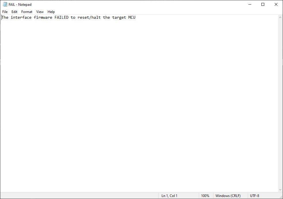

0693W000006FY9fQAG.pngHello,
I get this file in my board. What is the problem?
Updated all drivers, tried setting BOOT0 to high and then updated them but still nothing, any ideas?

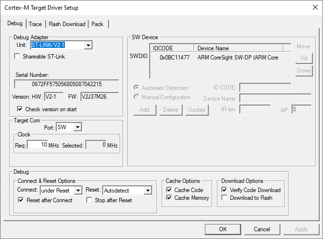

Hello
In STLink settings, change the reset options. Try "connect under reset" and / or use "hardware reset".

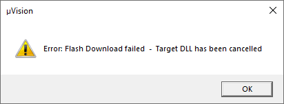

0693W000006FYG7QAO.pngBut get this error:

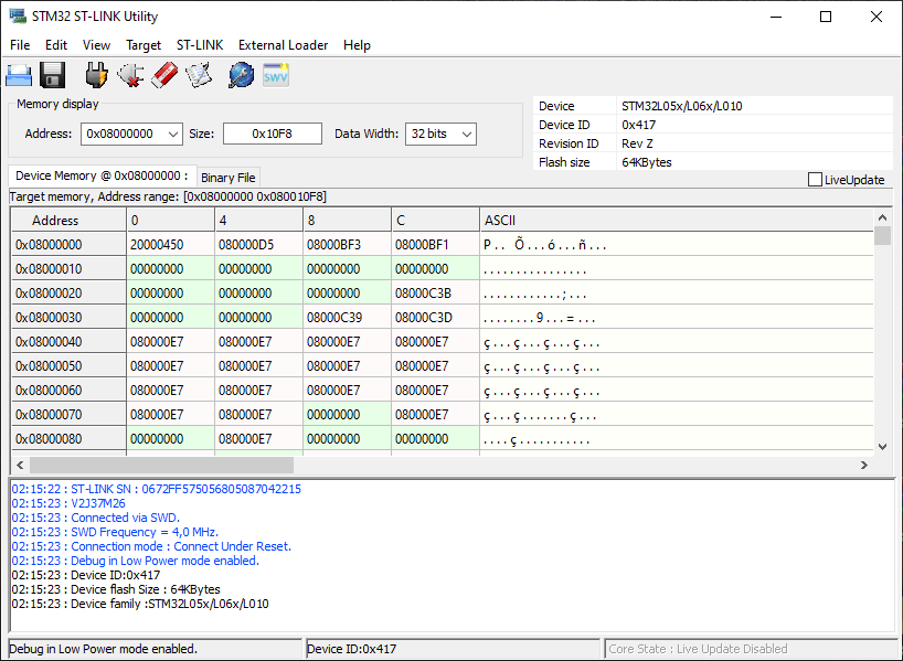

RGudo.1
No man still error. I think the problem is somewhere else. I tried under reset, pre-reset, normal. Still errors.
But in KEIL program can't connect
Select a slower connection speed​
