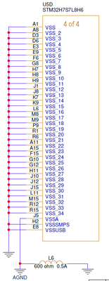

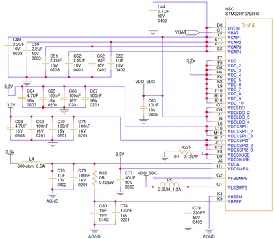

Hello Team,
We are developing our new project by using STM32H7S7L8H6. We want to use STM32H7S7L8H6 in SMPS mode. So, refer attached schematic design image with SMPS mode. Request you to please review it and provide your valuable inputs.

VCAP capacitors are a bit off from recommended.
VSS and VSSA should be connected directly. Technically they can be different but you need to ensure they're off by no more than 50 mV which I doubt a 600 Ohm resistor will do.
Tying VREF+ to VDDA which is downstream of VDD by 600 Ohm seems suboptimal. Reference voltage will be bouncing around as current is drawn.

Hello @TDK ,
Thanks for the feedback.
Please give your confirmation for below points
1) So, as per my understanding, we must connect VSS directly with VSSA and same for VREFM.
2) So, we need to remove L4 & L6 (600-ohm bead)?
3) We are not using USB. So, what to do with DVDD pin?
