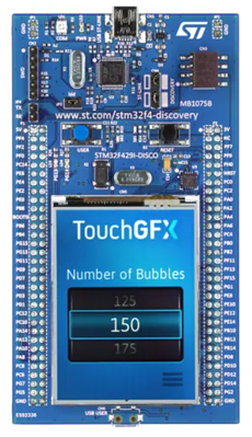

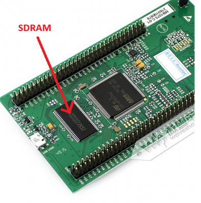

No exactly a ZIO connector (No ST board has both ZIO connector + SDRAM) but I can suggest STM32F429-DISCO board that has an onboard SDRAM + male  connectors. almost all pins are exported externally.
Top:
Bottom:
STM32F429 MCU datasheet

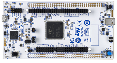

You mean the double-row Arduino headers? Like this:
That's a feature of the board - not the MCU.
They are found only (I think) on the Nucleo-144 boards.

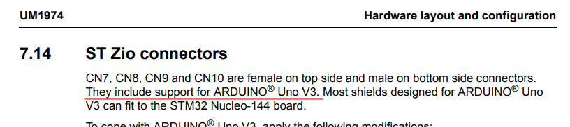

I thought Zio meant the double-row headers on the Arduino layout ?
That disco just has standard 0.1" two-row headers ?
PS:
https://www.st.com/resource/en/user_manual/um1974-stm32-nucleo144-boards-mb1137-stmicroelectronics.pdf#page=37

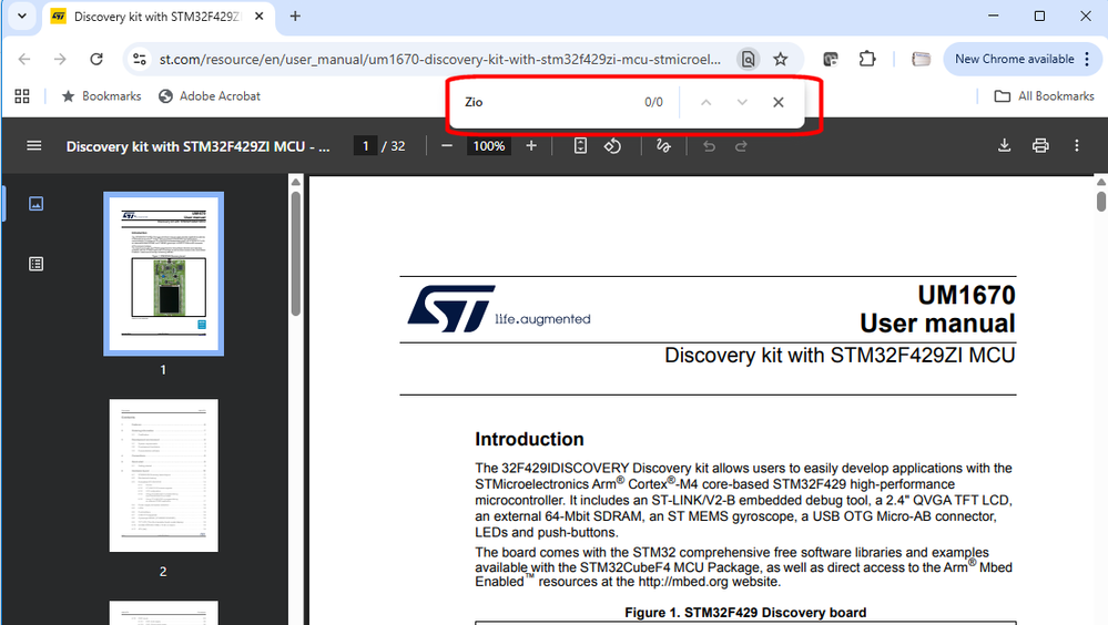

There is no mention of "Zio" in the STM32F429-DISCO manual:
That depends on what the OP means by "ZIO". I think he needs that most of IOs are available on the board.
For the ZIO mentioned in the user manual, I don't think there is a board fitting: Arduino ZIO + SDRAM.
And I think STM32F429-DISCO fits most of the OP requirements.
