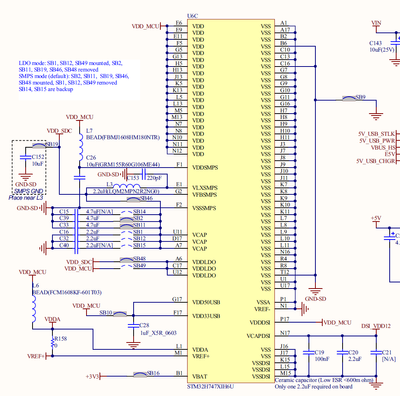

I have bought the STM32H747-DISCO kit for testing and I want to test at the max frequency (480MHz). I'm aware of the requirements for the 480MHz, I have followed the user manual:
Desoldered and soldered relevant SBs for LDO operation.
Updated the code to use the LDO, set the 'VOS 0':
if (HAL_PWREx_ConfigSupply(PWR_LDO_SUPPLY) != HAL_OK)
	return false;
__HAL_PWR_VOLTAGESCALING_CONFIG(PWR_REGULATOR_VOLTAGE_SCALE0);
while (!__HAL_PWR_GET_FLAG(PWR_FLAG_VOSRDY))

HSE frequency is 25MHz (obviously). Yet the application always fails inside 'HAL_RCC_OscConfig', precisely at line 833 of 'stm32h7xx_hal_rcc.c', STM32H7 FW package 1.11.0 -> Github link (wait for PLL ready timeouts).
At 400MHz (PLLN = 160 @ VOS1) works absolutely fine. I was able to push to around 420MHz @ VOS0, any further and the PLL ready is timeouting. Any ideas ?

Well, stupid me.. I have missed the PLL VCO Configuration.
//Shall be VCO WIDE
//RCC_OscInitStruct.PLL.PLLVCOSEL = RCC_PLL1VCOMEDIUM;
RCC_OscInitStruct.PLL.PLLVCOSEL = RCC_PLL1VCOWIDE;
Maybe it will help somebody, to pay attention to that setting as well. This post was my last resort, I have spent like a week on that..
