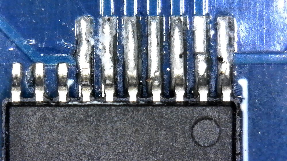

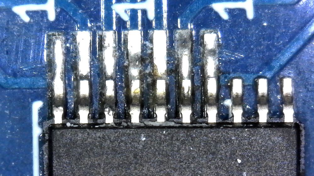

I just pulled one off a board and soldered it to a breakout board. Still the same behavior.
These are supposed to be "virgin" devices, not preprogramed?
If you're sure power supply and wiring to STLink is ok then devices are definitely broken. Could you attach photos of top side of one? Maybe from different viewing angles, so reflection of surface could be evaluated?

This doesn't really explain why the chip on the breakout doesn't work. I'll get some photos of that under my microscope camera soon.
These are the pics of my breakout board. I only had a 14 pin board but it is sufficient for the pins I need. 0693W00000KdfxHQAR.jpg0693W00000KdfxCQAR.jpg
