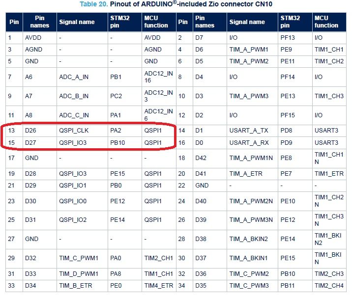

Issue with QSPI/OCTOSPI pins on NUCLEO-L552ZE-Q (MB2581 Rev 4)
https://www.st.com/resource/en/user_manual/um2581-stm32l5-nucleo144-board-mb1361-stmicroelectronics.pdf
PA1 OCTOSPI1_DQS
PA2 OCTOSPI1_NCS not QSPI_CLK
PB10 OCTOSPI1_CLK not QSPI_IO3

Hello @Community member​ ,
Thanks for pointing out this issue.
An internal ticket (number 124915) is submitted in order to correct the User Manual.
