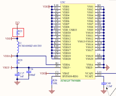

STM32F7508-DK current measurement
Sule_akcy
How can I measure the sleep current of the chip on the STM32F7508-DK board?
mƎALLEm
Maybe you need to remove R21 for this:

Andrew Neil
such facilities would be described in the User Manual for the board - have you checked?
