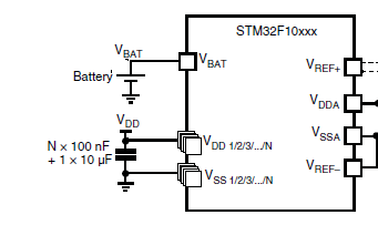

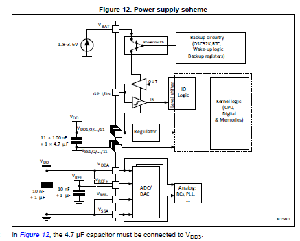

0690X00000BwCEZQA3.png0690X00000BwCEtQAN.pngHi,
In the STM32F103RDT6 , The datsheet showing VDDA pin needs 10nf AND 1Uf. But in AN2586 reference document, it shows 100nf and 1Uf. which one is correct?
Warm regards,
Monisha OM
1 REPLY 1
waclawek.jan
The particular value of 10nF/100nF is not that important. Routing, layout of ground, and placement (as close as possible) of the ceramic capacitors in supply is more important that their particular value.
