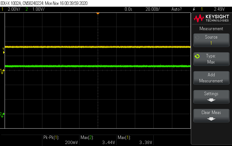

Here is a scoop image:
ch1 is reset
ch2 is the 3V3 rail, it is 3.44V but stil under the 3.6V
0693W000005BQVRQA4.pngIt has been running for 5 min and still no changes on ch1 and ch2.
Tested the reset and works how it should work when you pull it down.

As there is no activity on NRST, will assume the core isn't resetting it self, and you need to look more critically at your code, and if it ends up in the Error_Handler() or HardFault_Handler()
