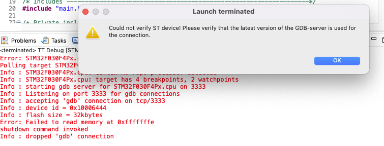

I did follow the video, but I could not flash successfully.
I use STM32F030F4P6 kit and ST-LINK V2.

Also, "Launch terminated" popped up and showed me "Could not verify ST device! Please verify that the latest version of the GDB-server is used for the connection".
I am thinking I am using OCD, not GDB. Why did I get this warning?

_legacyfs_online_stmicro_images_0693W00000bhudcQAA.pngThe error I got

CM0(+) parts generally have slower connectivity speed tolerances.
These low pin count devices also have pin level conflicts. You kind of want a short spin loop in the reset Handler to give the debugger an access window, and you want to avoid going into low power modes, reassigning pin function or disabling debug connectivity if you want to be able to reconnect to the device.
Y​ou should have NRST wired, and you can try pulling BOOT0 pin High.
