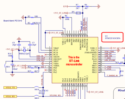

@syed wrote:
Hi @STTwo-32
I already checked above link and found STM32F103 schematics.
Are you, perhaps, looking at the ST-Link microcontroller - U2 on Sheet 4 - which is an STM32F103CBT6 ?
The STM32F030 is U5 - marked "MCU_LQFP64" on Sheet 3.

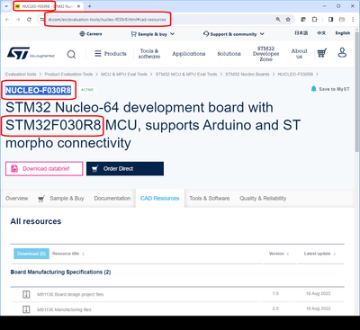

This is the link that @STTwo-32 gave:
https://www.st.com/en/evaluation-tools/nucleo-f030r8.html#cad-resources
It does take you to the Product Page for the NUCLEO-F030R8 board:

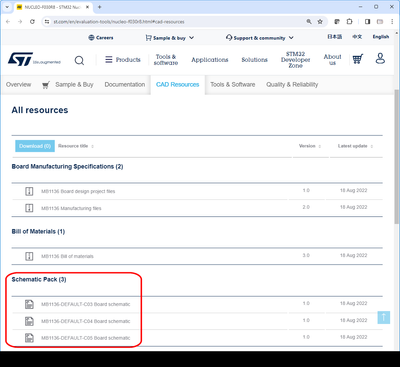

Scroll down to find the Schematics:
Download the pack which corresponds to the revision of board (C03, C04, or C05) which you have.
Note that the schematics are also in the 'Board design project files' download.
The MB1136 is the Schematic Pack of the Nucleo-F030R8 and other STM32 Nucleo-64 boards (mentioned in the introduction of the UM1724. The STM32F103 mentioned on the sheet 4 of the Schematic Packs is used just on the integrated ST-LINK v2-1.
