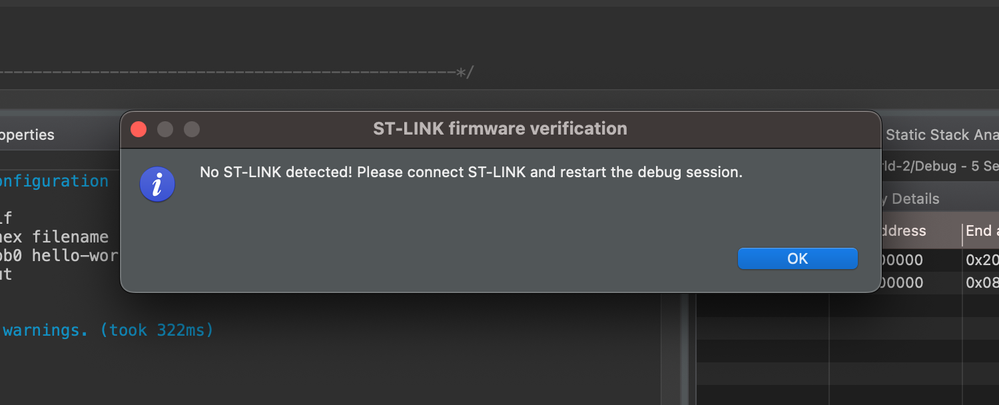

I'm running on Mac-OS with CubeIDE V1.12.1 (the latest at this time)
When I try to connect a target using SWD with my STLINK-V3PWR probe I get the following:
"No ST-Link detected" in a popup named : "ST-LINK firmware verification"

I found the solution.
I add the idea to make a new fresh install of STM32CubeIDE and downloaded the installer.
But only making the install of st-stlink-server.2.1.1-1.pkg was enough to solve this problem. It seems that this driver update was not properly installed with IDE updates !!
thank's for support

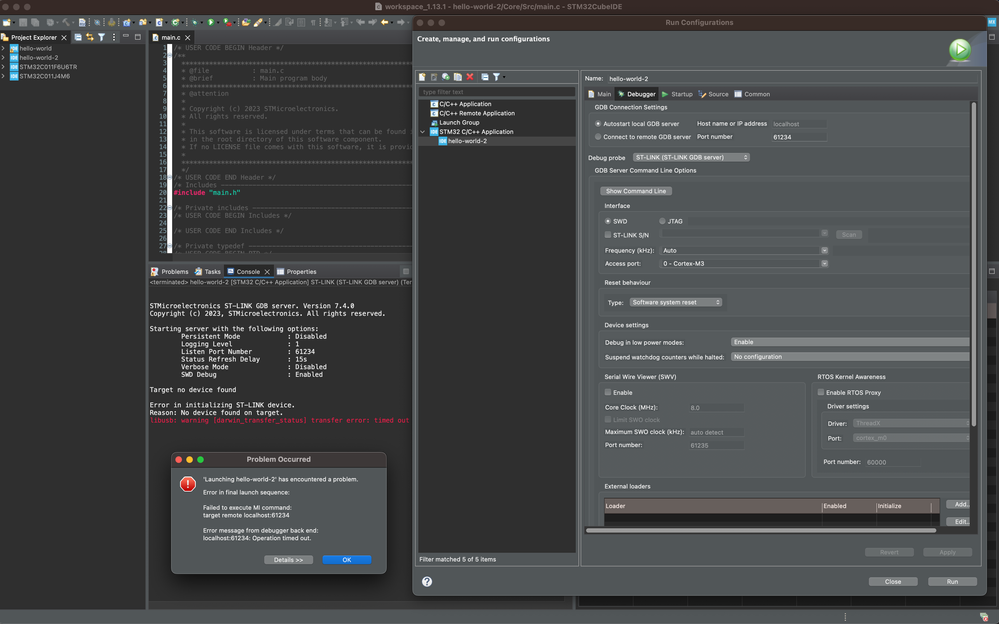

I also have an issue with my STLINK-V3PWR. When I want to run a project using SWD within STM32CubeIDE, it gives the following error:
Error in initializing ST-LINK device.
Reason: No device found on target.

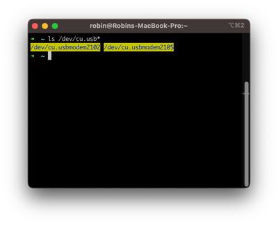

libusb: warning [darwin_transfer_status] transfer error: timed out
When the STLINK-V3PWR is not connected at all, it does indicate that there is no ST-LINK.

STM32CubeIDE errorSTM32CubeIDE error

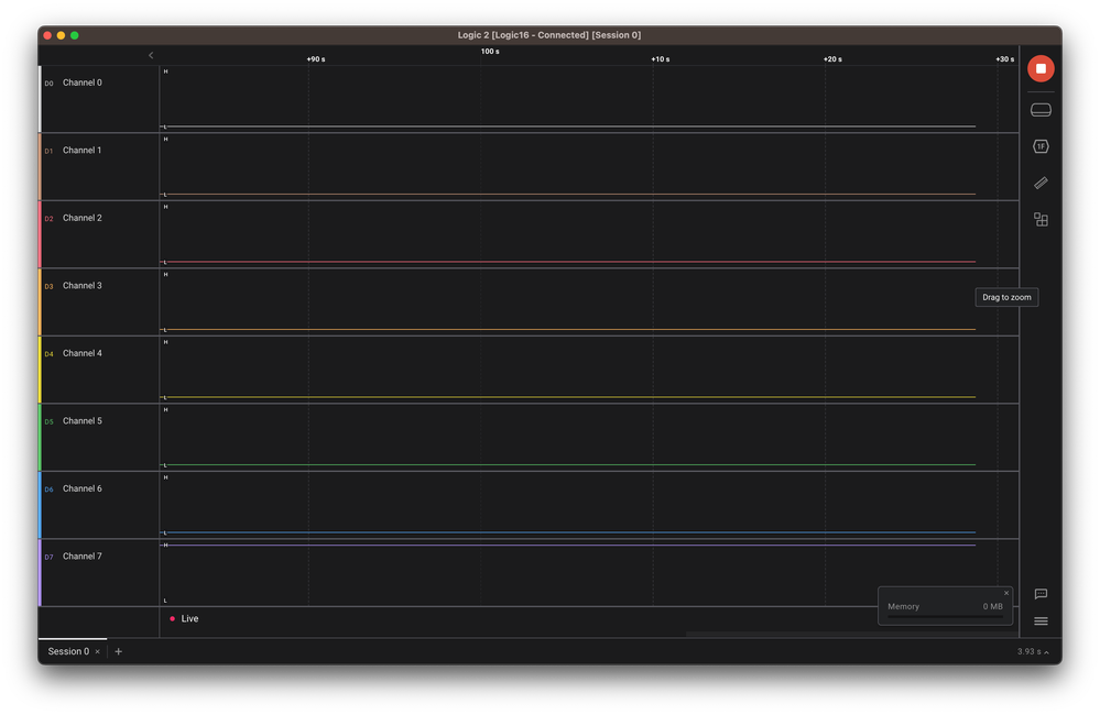

To check if the wiring was wrong, I've checked all the signals on the DEBUG port using my digital analyser. It seems that there is no activity at all. DEBUG pins 7 (GND) and 11 (GNDDetect) are connected through a 100k resistor. Channel 7 is from AUX.

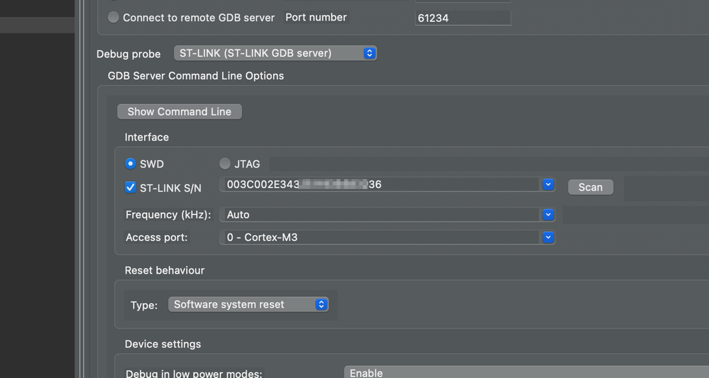

And it is detected with serial in STM32CubeIDE
STLINK detected with serialSTLINK detected with serial
