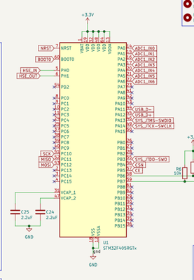

Hi everyone,
I recently build a custom PCB with a stm32f405, but every time I try to connect to it with a stlink v2 it gives an error.
Target no device found
Error in initializing ST-LINK device.
Reason: No device found on target.
I already managed to program a stm32 blue pill with the stlink, so I am starting to think the problem lies in my PCB.
Thanks in advance.

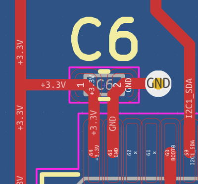

September 20, 2023
Your schematic symbol is missing pin 63 (VSS). If this is left unconnected on the board, it would explain the error.
wv1106Author
September 20, 2023
It indeed doesn't show in the schematic for some reason but it is connected.
