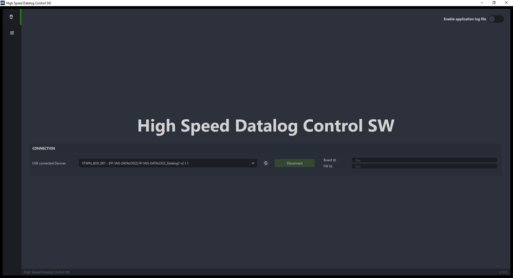

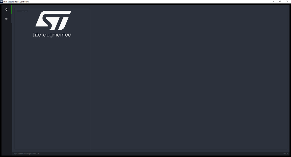

I am trying to use the Python GUI, I can connect to the board....
But there is nothing on the screen once I have connected...
Does the Python GUI work with the FP-SNS-DATALOG2 software ?

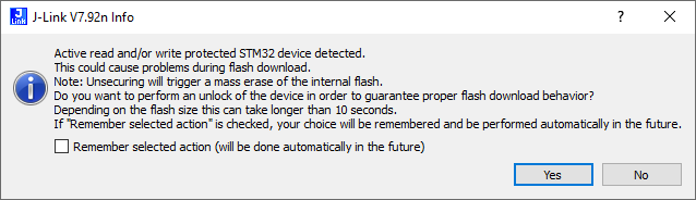

At the time of flashing the software to the board, I wasn't aware of the different flash banks on the micro.  Im not sure if its related to the flash banks, but when flashing I got the the following warning which I clicked yes to...
Hopefully I haven't broken anything by doing this ?

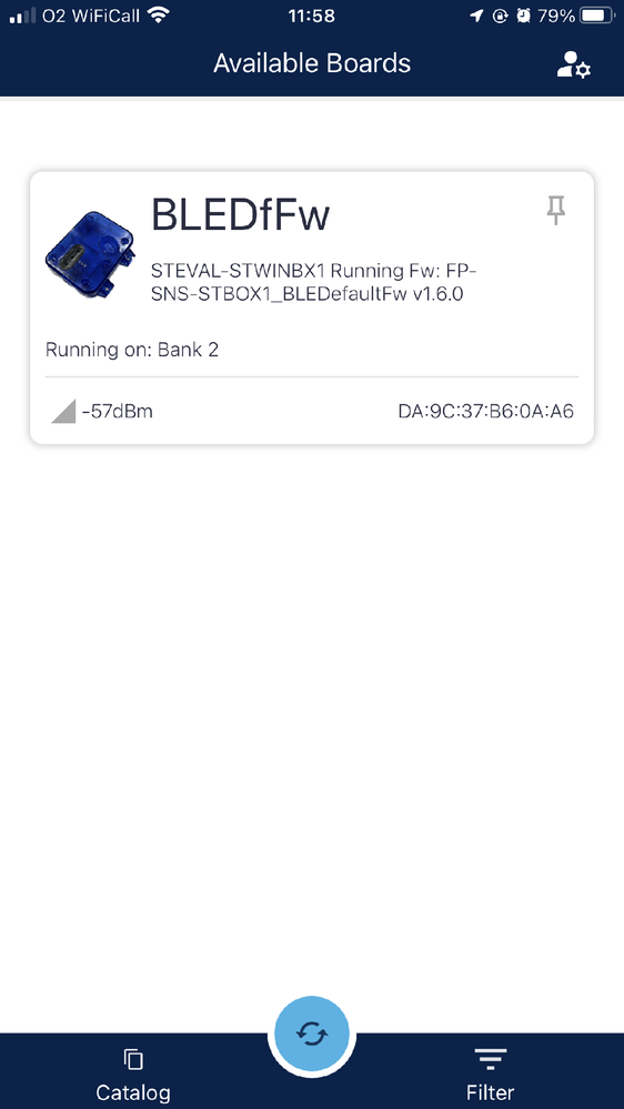

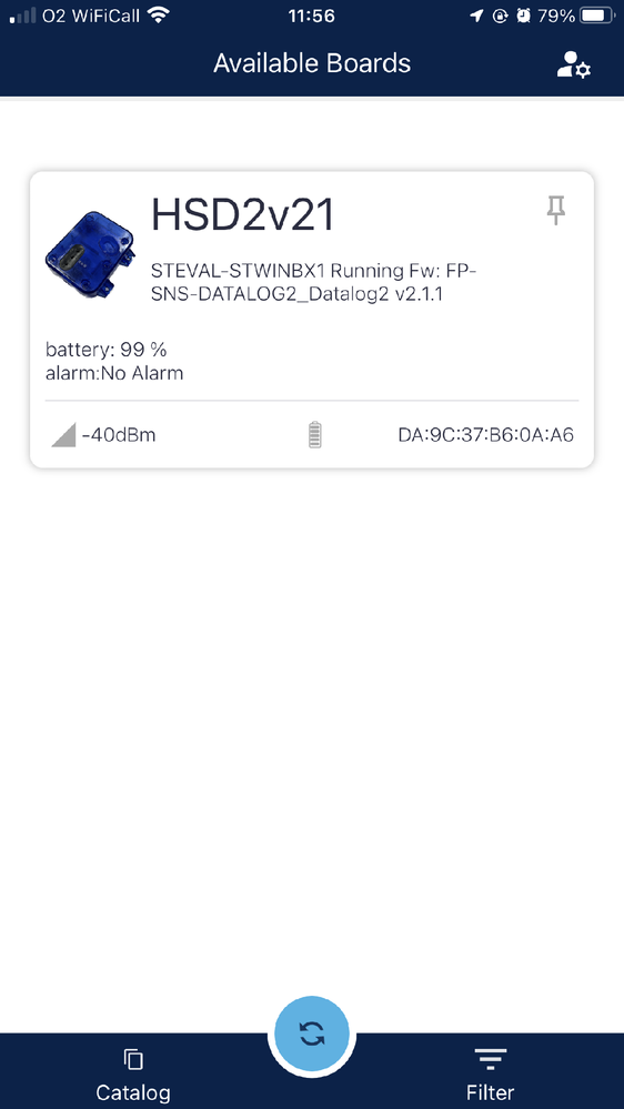

I am able to use the phone app to swap firmware...
If I swap to BLEDfFw firmware (running on bank 2), the Python GUI does not even detect the device.

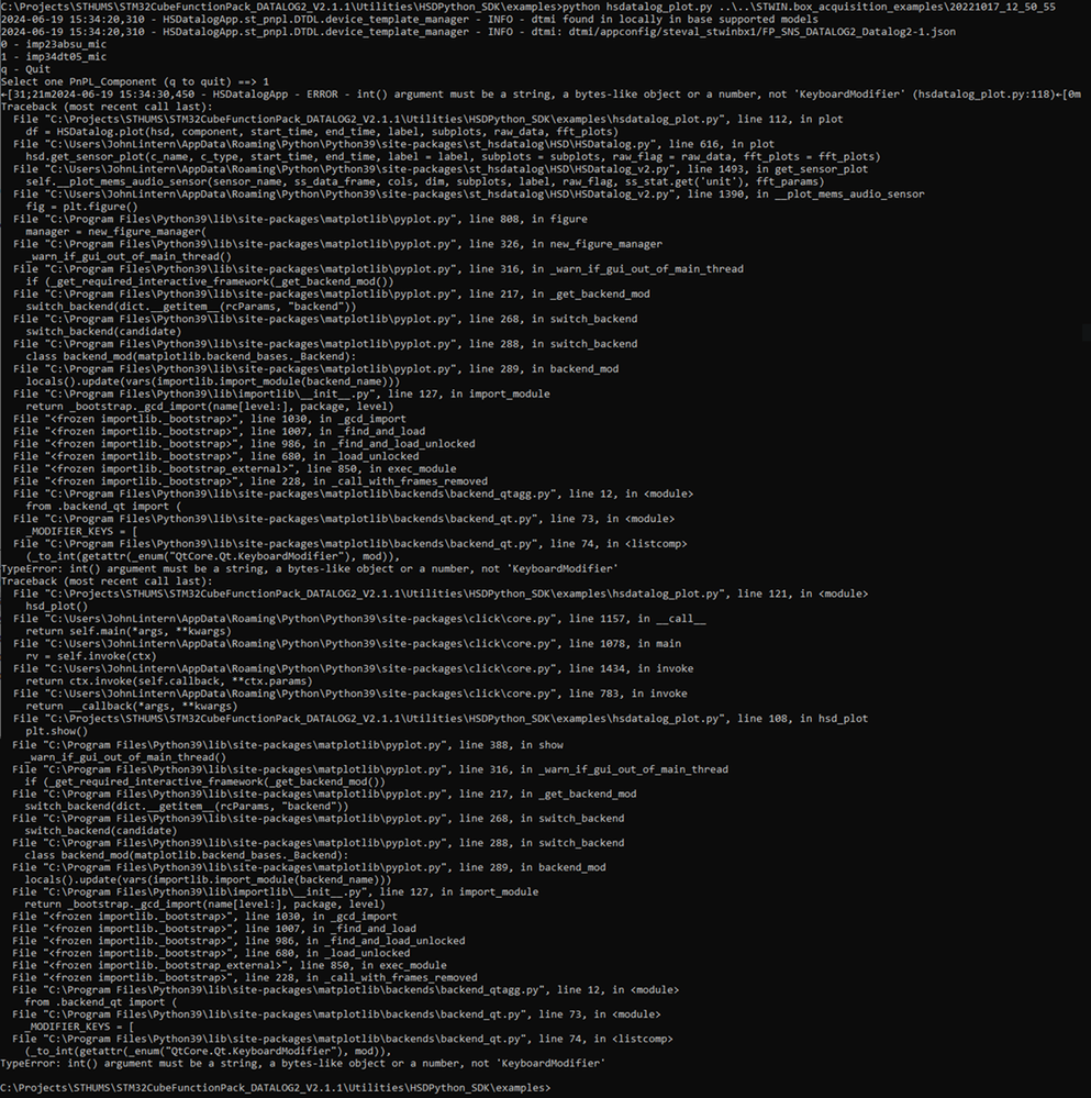

I can't get hsdatalog_plot.py to work either.
I try to plot one of the examples that come with the software zip file using...
python hsdatalog_plot.py ..\..\STWIN.box_acquisition_examples\20221017_12_50_55
It then asks which sensor measurement I want to plot...
0 - imp23absu_mic
1 - imp34dt05_mic
q - Quit
Select one PnPL_Component (q to quit) ==> 1
I then get a whole lot of errors...
←[31;21m2024-06-19 15:34:30,450 - HSDatalogApp - ERROR - int() argument must be a string, a bytes-like object or a number, not 'KeyboardModifier' (hsdatalog_plot.py:118)←[0m
Traceback (most recent call last):
 File "C:\Projects\STHUMS\STM32CubeFunctionPack_DATALOG2_V2.1.1\Utilities\HSDPython_SDK\examples\hsdatalog_plot.py", line 112, in plot
 df = HSDatalog.plot(hsd, component, start_time, end_time, label, subplots, raw_data, fft_plots)
 File "C:\Users\JohnLintern\AppData\Roaming\Python\Python39\site-packages\st_hsdatalog\HSD\HSDatalog.py", line 616, in plot
 hsd.get_sensor_plot(c_name, c_type, start_time, end_time, label = label, subplots = subplots, raw_flag = raw_data, fft_plots = fft_plots)
 File "C:\Users\JohnLintern\AppData\Roaming\Python\Python39\site-packages\st_hsdatalog\HSD\HSDatalog_v2.py", line 1493, in get_sensor_plot
 self.__plot_mems_audio_sensor(sensor_name, ss_data_frame, cols, dim, subplots, label, raw_flag, ss_stat.get('unit'), fft_params)
 File "C:\Users\JohnLintern\AppData\Roaming\Python\Python39\site-packages\st_hsdatalog\HSD\HSDatalog_v2.py", line 1390, in __plot_mems_audio_sensor
 fig = plt.figure()
 File "C:\Program Files\Python39\lib\site-packages\matplotlib\pyplot.py", line 808, in figure
 manager = new_figure_manager(
 File "C:\Program Files\Python39\lib\site-packages\matplotlib\pyplot.py", line 326, in new_figure_manager
 _warn_if_gui_out_of_main_thread()
 File "C:\Program Files\Python39\lib\site-packages\matplotlib\pyplot.py", line 316, in _warn_if_gui_out_of_main_thread
 if (_get_required_interactive_framework(_get_backend_mod())
 File "C:\Program Files\Python39\lib\site-packages\matplotlib\pyplot.py", line 217, in _get_backend_mod
 switch_backend(dict.__getitem__(rcParams, "backend"))
 File "C:\Program Files\Python39\lib\site-packages\matplotlib\pyplot.py", line 268, in switch_backend
 switch_backend(candidate)
 File "C:\Program Files\Python39\lib\site-packages\matplotlib\pyplot.py", line 288, in switch_backend
 class backend_mod(matplotlib.backend_bases._Backend):
 File "C:\Program Files\Python39\lib\site-packages\matplotlib\pyplot.py", line 289, in backend_mod
 locals().update(vars(importlib.import_module(backend_name)))
 File "C:\Program Files\Python39\lib\importlib\__init__.py", line 127, in import_module
 return _bootstrap._gcd_import(name[level:], package, level)
 File "<frozen importlib._bootstrap>", line 1030, in _gcd_import
 File "<frozen importlib._bootstrap>", line 1007, in _find_and_load
 File "<frozen importlib._bootstrap>", line 986, in _find_and_load_unlocked
 File "<frozen importlib._bootstrap>", line 680, in _load_unlocked
 File "<frozen importlib._bootstrap_external>", line 850, in exec_module
 File "<frozen importlib._bootstrap>", line 228, in _call_with_frames_removed
 File "C:\Program Files\Python39\lib\site-packages\matplotlib\backends\backend_qtagg.py", line 12, in <module>
 from .backend_qt import (
 File "C:\Program Files\Python39\lib\site-packages\matplotlib\backends\backend_qt.py", line 73, in <module>
 _MODIFIER_KEYS = [
 File "C:\Program Files\Python39\lib\site-packages\matplotlib\backends\backend_qt.py", line 74, in <listcomp>
 (_to_int(getattr(_enum("QtCore.Qt.KeyboardModifier"), mod)),
TypeError: int() argument must be a string, a bytes-like object or a number, not 'KeyboardModifier'
 File "C:\Projects\STHUMS\STM32CubeFunctionPack_DATALOG2_V2.1.1\Utilities\HSDPython_SDK\examples\hsdatalog_plot.py", line 121, in <module>
 hsd_plot()
 File "C:\Users\JohnLintern\AppData\Roaming\Python\Python39\site-packages\click\core.py", line 1157, in __call__
 return self.main(*args, **kwargs)
 File "C:\Users\JohnLintern\AppData\Roaming\Python\Python39\site-packages\click\core.py", line 1078, in main
 rv = self.invoke(ctx)
 File "C:\Users\JohnLintern\AppData\Roaming\Python\Python39\site-packages\click\core.py", line 1434, in invoke
 return ctx.invoke(self.callback, **ctx.params)
 File "C:\Users\JohnLintern\AppData\Roaming\Python\Python39\site-packages\click\core.py", line 783, in invoke
 return __callback(*args, **kwargs)
 File "C:\Projects\STHUMS\STM32CubeFunctionPack_DATALOG2_V2.1.1\Utilities\HSDPython_SDK\examples\hsdatalog_plot.py", line 108, in hsd_plot
 plt.show()
 File "C:\Program Files\Python39\lib\site-packages\matplotlib\pyplot.py", line 388, in show
 _MODIFIER_KEYS = [
Below is the screen capture...
