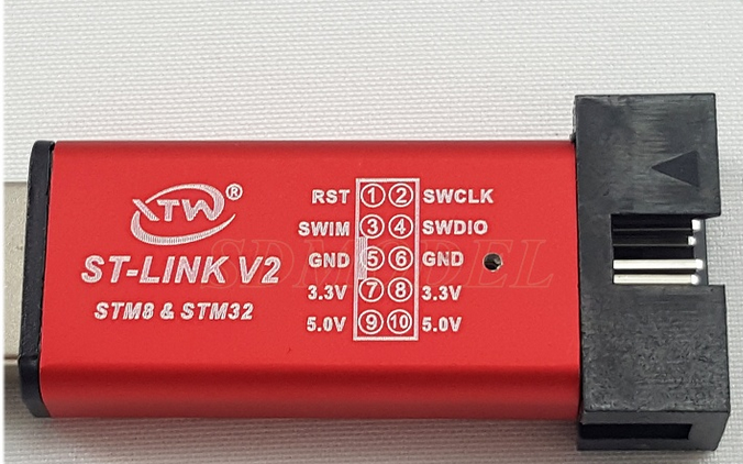

Posted on June 23, 2017 at 18:51
I am not sure which pin is CN3.15. The ST-Link I have is shown below. RST is connected with my MCU's NRST.
I hope I am not having issues because it is not made by ST. Do you think that's a possibility?

Posted on June 26, 2017 at 10:26
Hello
Mirza.Fahad
Seems this probe is not working properly.
May I suggest you to get ST Standalone probe or keep using Nucléo STLINK/V2-1 ?

Posted on June 26, 2017 at 11:55
I had very similar issues with that knock off ST-Link. As far as I can tell the RST pin is driven only when used in SWIM more (for STM8), not SWD.
I'd suggest you reflash the thing with
https://github.com/x893/CMSIS-DAP
and remap the RST signal from PB0 to PB6.
