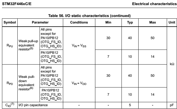

I am designing a PCB which uses the STM32F446 MCU. I have the first revision done and working. But I am wondering if all the pull-up and -down resistors on the board can be excluded and use the internals instead?
The board has the following components connected with pull up/down:
->Micro SD card in SPI mode
->User button
->UART connection with other board
When should you use external resistors and when can you rely on the internals?
Thank you for any thoughts on the topic.

I, personally, use external pull up/down resistors in cases which the pull up/down resistor should be known and an specific value. In other cases like your cases, it would be great to use internal pull up/down resistors.

I don't pull up for SPI interface,
Internal pull up/down for Button is enough.
As for UART....I think it's only necessary for external pull up if it's 1 wire half-duplex case.

I have found that most of the external pull up/down resistors can be excluded. However, when working with the SD-card, it is advisable to use an external pull-up resistor for the chip select, to avoid sending bad information to the card during initialization. From this, i have concluded that anything that needs specific voltage levels before and during initialization, or needs a specific value, should have external resistors. Else, i will use the external resistors instead.
