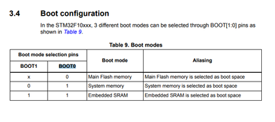

‎2023-10-04 05:39 AM
Thanks for the information.
That USB part is fine .but we have a confusion on what exactly happens between the boot0 and boot1
Can you please explain that part ?
why we use boot0 and boot1 ?
Best regards,
Nitheesh
‎2023-10-04 06:51 AM - edited ‎2023-10-04 06:51 AM
The reference manual will explain how BOOT0 and BOOT1 functions.
The stm32f103 doesn't have a USB bootloader, as AN2606 will point out.
‎2023-10-04 07:47 AM - edited ‎2023-10-05 12:58 AM
Hello @nitheesh123 :
As said by @TDK the stm32f103 has not native system memory USB bootloader but I guess that that you want to develop your own USB bootloader ?
In that case you can get inspired by the algorithm used by other mcus devices in AN2606.
If you want to use ST bootloader from system memory, then you can not use USB with this device.
Here below an extract from the reference manual :
If you want to boot from system memory then BOOT1 shall be set to 0 dans BOOT0 to 1.
Please report to reference manual for all detailed information on boot configuration:
Best regards
Mikael
