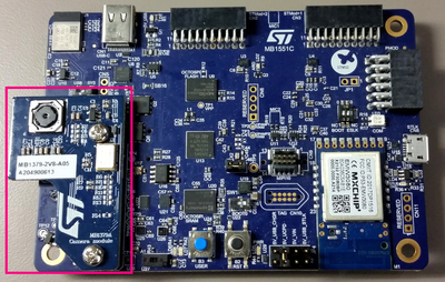

I want to connect B-CAMS-OMV (cam module ) to B-U585-IOT02A ( discovery kit). But there is no info bout that connection. I already read the user guide bout both. Can you give me some information or solution bout Connection with B-CAMS-OMV and B-U585-IOT02A ?

On the B-U585I-IOT02A Discovery kit, it is possible to connect a camera module such as B-CAMS-OMV using
the CN7 camera connector.
For this connection you need only to connect the MB1379 camera module mounted on MB1683 to B-U585I-IOT02A by using CN2 connector in B-CAMS-OMV and CN7 connector in B-U585I-IOT02A as shown in the below figure.
