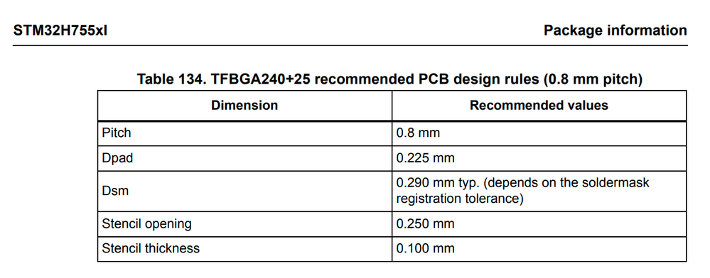

We have some problem with soldering this package.
Does it correct for ball diametr 0.4mm make Dpad = 0.225, Dsm = 0.29mm?

Dear @VTimo​ ,
For H7, Datasheet will be updated with the following values:
Dpad = 0.3mm and Dsm = 0,4mm

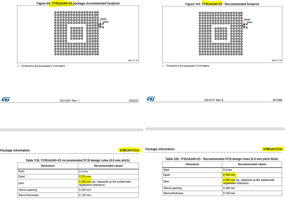

Manuel Del Basso
Comparing the Recomended footprint for TFBGA240+25 between STM32H757XI and STM32H753XI
datasheets, there are still differences.
https://www.st.com/resource/en/datasheet/stm32h757xi.pdf
https://www.st.com/resource/en/datasheet/stm32h753xi.pdf

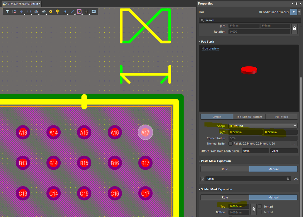

In the CAD resources library from ST the BGA pads are of size 0.229mm.
https://www.st.com/en/microcontrollers-microprocessors/stm32h757xi.html#cad-resources
0693W00000Y9hBQQAZ.pngI'm interested in the correct footprint for stm32h757xi.
Kind regards, manuel
We are aware of that and all the datasheets related to STM32H74x and STM32H75x devices will be updated with the new values.
All these datasheets will be available soon on the web.
Manuel Del Basso
ok, so the 0.3mm and 0.4mm are correct for my stm32h757xi.
Thanks!
Yes I confirm. And I already double checked that it was already fixed in an internal revision of STM32h757 datasheet that will be available soon on ST website.
