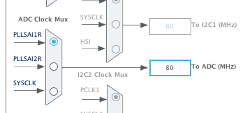

currently the input frequency is 500kbps, the ADC is configured to 12bit resolution, sampling time of 247.5 cycles. In the first post you can see the settings for both ADC. The clock is set to 80MHz.
ok, something I have found, the `printf` over UART might be influencing the final wave, as you can see, I am making one GPIO pin LOW and HIGH to check on the oscilloscope, when I am using printf statements I get some more defined squares as signal, without printf I get more uneven square shape signals in the output.
This is not a frequency but a bitrate. As I said you need to adapt your ADC sampling frequency according to your signal input.

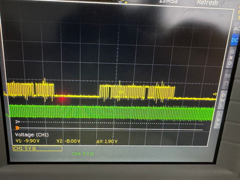

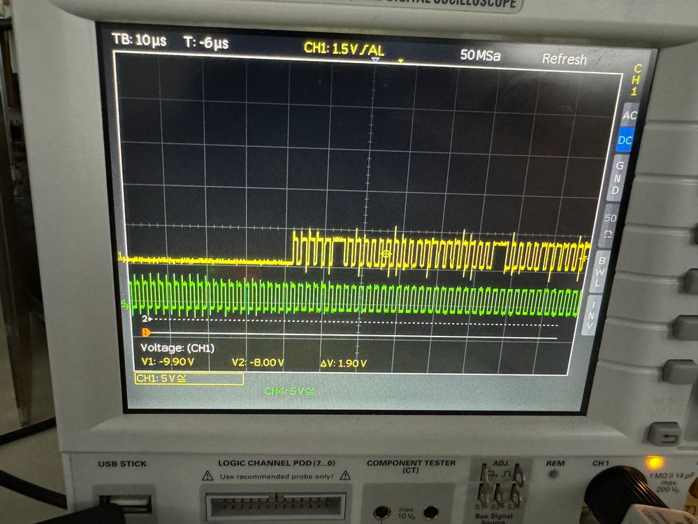

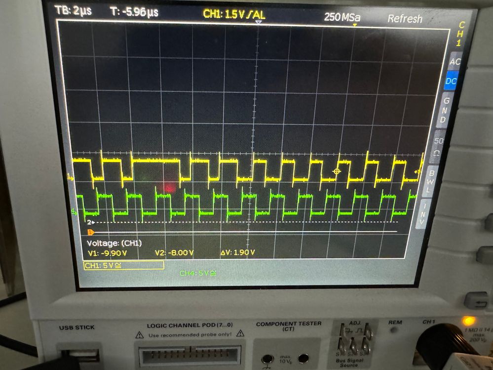

ok, I think I have nailed the ADC parameters with the signal and I can see better output results in the oscilloscope. I see the frequency on the pyboard to 500kHz and the ADC is configured to the max sampling frequency with two ADC. However, I see some gaps, see the screenshots. The green one is the input signal and the yellow is the signal I generate based on the ADC values.
In this one, the generated signal is a bit shifted/delayed compared to the input signal, but it matches most of the time, ignoring the wide one on the left side which I don't know what happened.
If I zoom out the gaps a more dramatic:
Is it possible to know what could be causing these, or how could they be corrected?
I removed any possible interrupt or print (even with DMA) to avoid any problem in the signal generation. I found my printf with DMA was causing the output signal to malform and not reflect the ADC values correctly.
