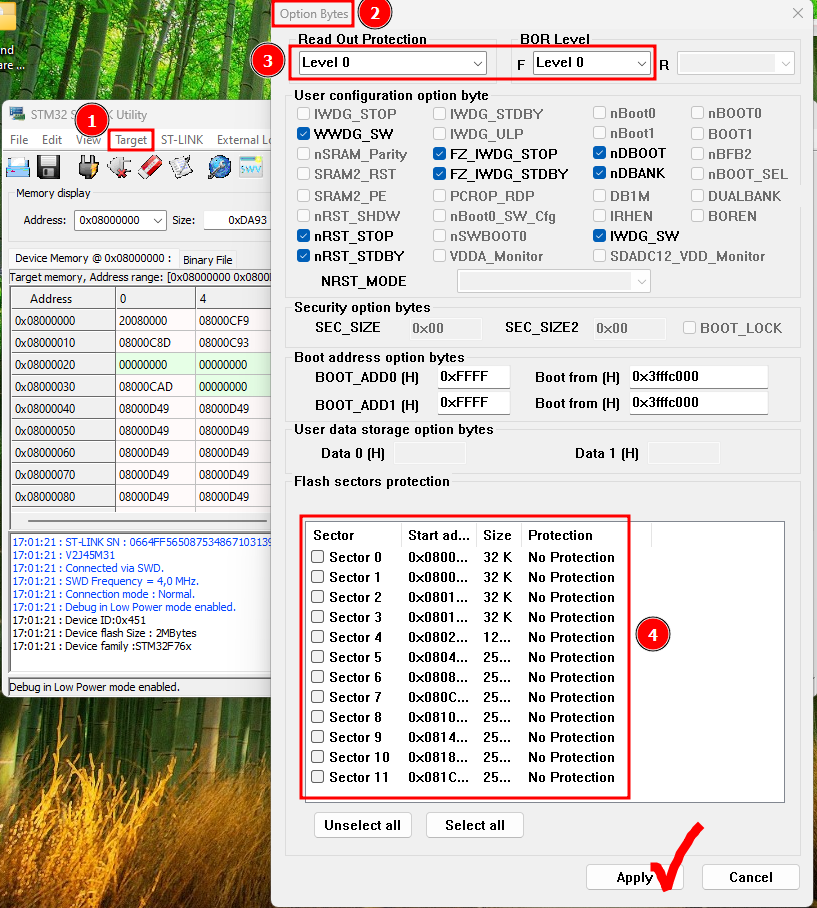

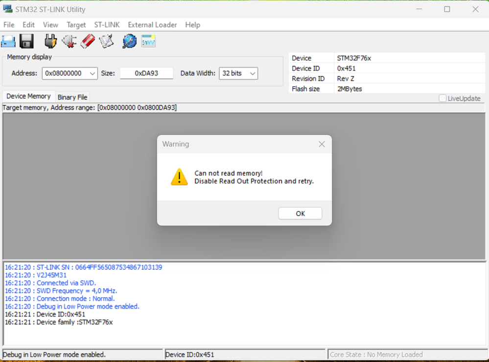

DK.7
Senior
After my experiments with Flash, I got an identical problem. How I fixed it is, see screen1.png2.png
