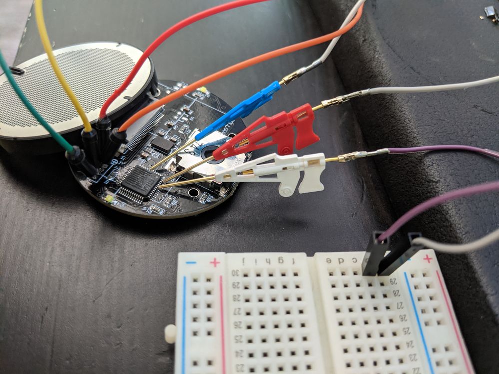

I'm trying to use a ST-LINKv2 to re-program a consumer device that I know has an STM32 of some kind inside (fairly sure it's a STM32L-something). I found four headers on the board that a continuity tester has shown to be Vdd, Vcc, SCLK, and SWDIO.
Connecting with only those 4 wires did not allow STM32CubeProgrammer to connect to the device. It gives the message "No STM32 target found!". Same with the ST-Link Utility. So I next tried tying boot0 high (w/ and w/out a 1k resistor). I have confirmed that this prevents the device's normal program from starting. Connection still fails. I then tried connecting NRST to the ST-LINK so that it could control hardware-reset. I can verify that trying to connect to the device does reset it over NRST. But it still can't connect
Port: SWD
Frequency: 100kHz
Mode: Under reset
Reset mode: Hardware Reset
Output:
12:57:17 : ST-LINK SN : 55FF6E066684564922161687
12:57:17 : ST-LINK FW : V2J37S7
12:57:17 : Board : --
12:57:17 : Voltage : 1.05V
12:57:17 : Error: No STM32 target found!
If I increase the frequency to 4000kHz, then the error changes to: "Error: ST-LINK error (DEV_TARGET_CMD_ERR)"
I've tried so many combinations of configurations, swapped the CLK/IO pins just to be sure, updated the ST-LINK firmware, but nothing fixes the connection. Am I missing something obvious here? Is it possible that the chip is locked-down during manufacturing so that it can't be modified?
Given they defaced the markings, would expect they set Read Out Protection and turned off SWD/JTAG

Just leaving a follow-up on this. I'm not certain yet whether the issue was with the RDP. I took the nuclear option and soldered a replacement MCU onto the board. It had the exact same problem (no target) until I found another tutorial on how to interface with bare MCUs. Video #5 in this post described how the SWCLK needs to be tied to Vcc, and SWDIO needs to be pulled to Vdd.
https://hackaday.io/project/25097-arm-microcontroller-bare-chip-tutorial-series
Adding that to the wiring setup allowed me to read from the new empty replacement.
‎2021-04-11 2:17 PM
SCLK/SWDIO are pulled up/down as needed internally, read the GPIO chapter in RM for your STM32. If external pullups/downs worked, it probably was coincidental or it masked some other problems. Long flying leads are often source of problems with high-speed signals, coupled with inadequate return/ground; and the breadboard is something I recommend to position strategically into the garbage pin.
‎2021-04-14 6:16 PM
Based on your comment, I decided to to a bit more fiddling. I've found that not having a pull-down on SWCLK ground did not affect things. However, with dozens of attempts either way, it can only read when SWDIO has a pull-up resistor.
Unfortunately without fabricating a custom connector, I'm stuck with the breadboard for now. Another thing I found is that selecting any frequency besides 4000kHz prevents reading. I thought selecting a lower frequency would reduce any signal integrity issues, but it does not connect when that's changed

It seems that you are correct. I did some googling on how to use openocd, and this blog post came up indicating that the target still needs external power
http://www.rudi-horn.de/Home/7-debugging-the-stmf-with-an-st-linkv-and-openocd
This is consistent with my experimentation. If I try to connect with openocd without a resistor, it gives me this output:
~ >>> sudo openocd -f interface/stlink.cfg -f target/stm32l5x.cfg -c 'adapter speed 4000'
Open On-Chip Debugger 0.11.0

Note the warning at the bottom about the voltage (1.4v is definitely too low). It's not totally clear how a pull-up resistor on SWDIO would change that (brings it up to 2.8v according to openocd), but it does.
If I remove the pull-up resistor _but also_ touch the original batteries to the contacts, the power again comes up to almost 3v. Here's the output when it successfully connects:

So it seems you're right, the pull-up is not necessary for normal operation. In fact when I provide the battery power, connecting at lower frequencies (even as low as 50) works. However, `mdb` isn't working as I would expect. I can't yet dump any flash data, but that's probably user-error. Here's what I get over telnet:
