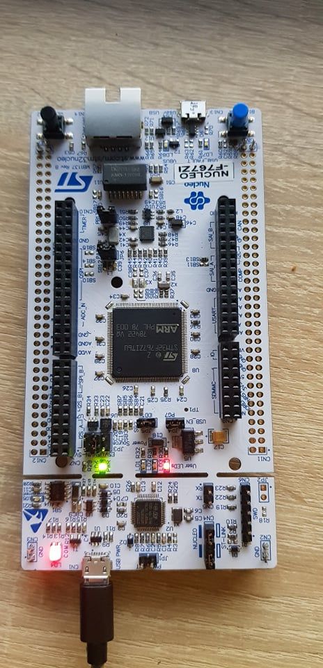

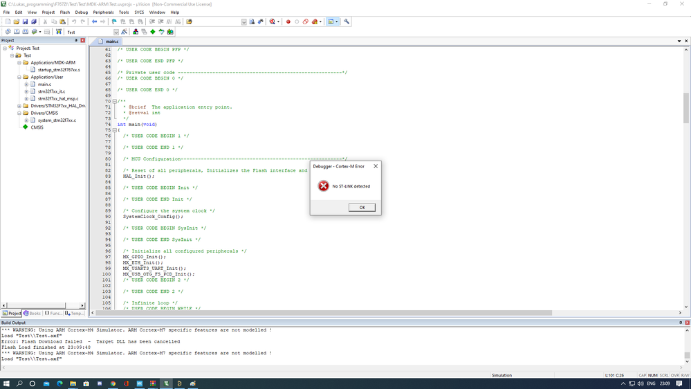

Hello, I have recently purchased stm32 nucleo-stm32F767ZI board but I am not able to get it to work - I cant debug/program any code for it because internal st link is not detected. Picture of my board:

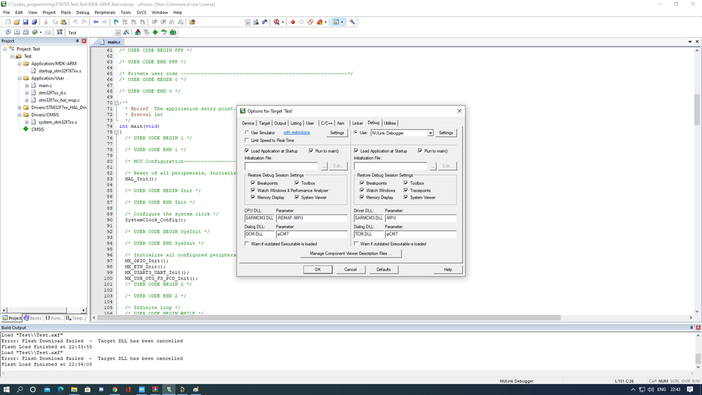

Debug settings:

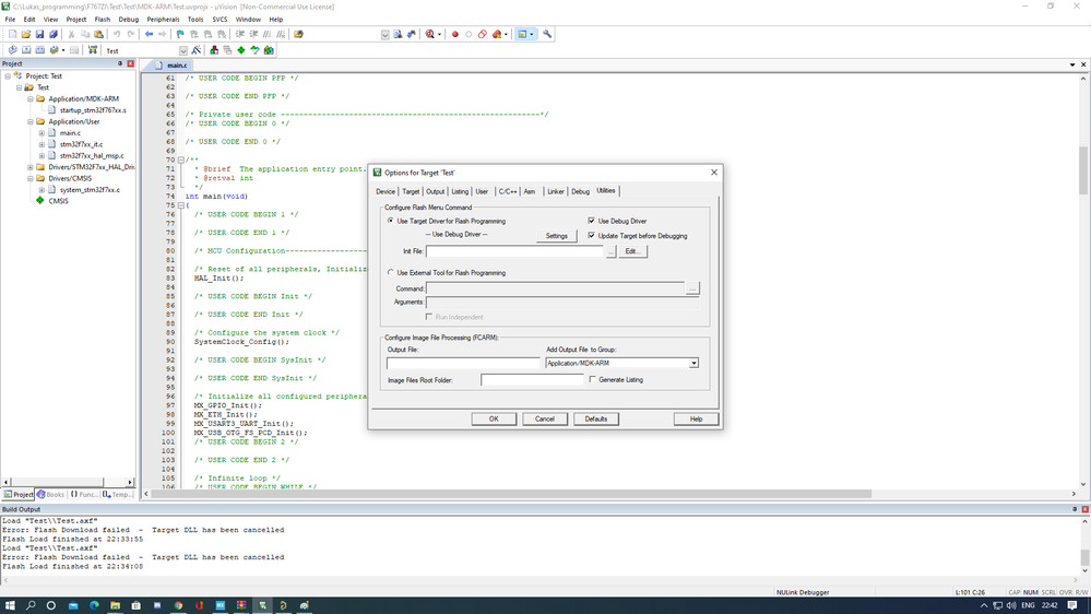

Target settings:

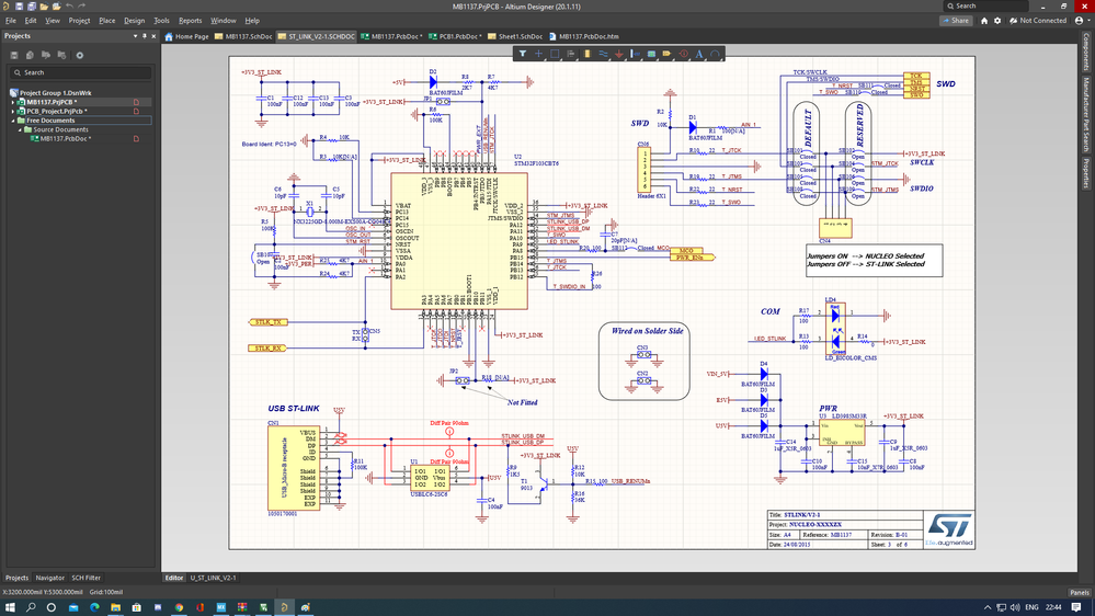

ST link schematic
I have tried to pull out two jumpers that select NUCLEO or ST-LINK but didint make any difference. Could someone give me hand to fix this problem. Thanks

Hmm, it is a bit complicated to talk to the embedded ST-LINK/V2-1 if you have selected the NULink Debugger (see your screen shot of the debug settings)...
