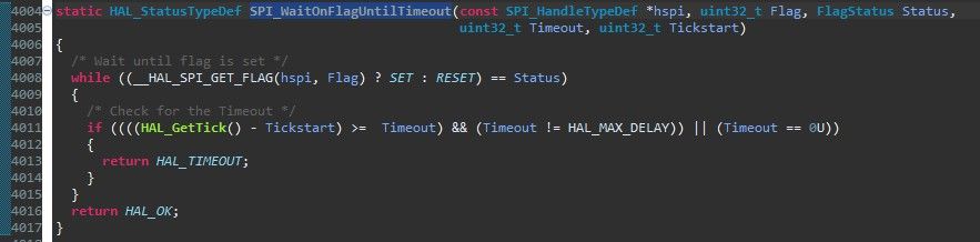

Trying to get SPI1 to work on the NUCLEO-H7S3L8.
Starting a new project from the Board Selector works with no problem, however starting from the MCU Selector, the HAL_SPI_Transmit gets stuck at in stm32h7rsxx_hal_spi.c in the while loop at line 4008.

Can you look at the signals on a scope or logic analyzer? Are the pins you're using free to use on the board? Check the schematic. What flag is it waiting for? Do the SPI example projects work correctly?

The issue appears to be that CubeMX is not setting things up correctly. It seems like extra setup is needed, but I dont see this info in the example documentation or anywhere. I hooked it up to a scope, but there is no clock produced. I believe the SPI_FLAG_EOT is the one that is not being set.
Thanks
With no clock, makes sense that EOT isn't getting set.
Might need to provide more info. Attach IOC file and project code. Hard to debug through a keyhole.

Can't see anything wrong with the code. Maybe initialize the pin as GPIO output and toggle and verify on a scope that it's working. Perhaps disconnect whatever external board you have connected for this check.
Missing something but not sure what it is.
Pin frequencies are set to HIGH, not VERY HIGH, but that should be sufficient for the clock rate.
