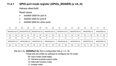

@BarryWhit ,
right, no "debug" setting needed, because chip begins after power up with the jtag pins enabled.
So as long as nobody writes any other setting to these pins...debug possible.
You can see this in rm , gpio settings at reset :
-> not all 00 , some on alternate function ->  for JTAG/SWD etc.
